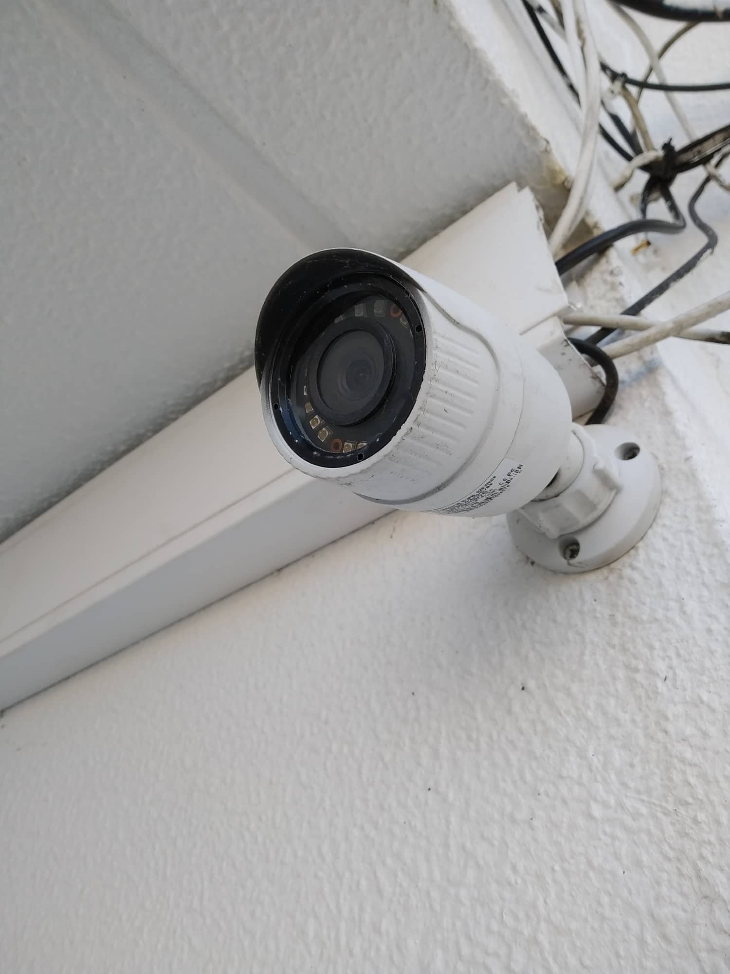

Camera - I have 3 of those cameras (the actual system supports up to 4 at the moment)

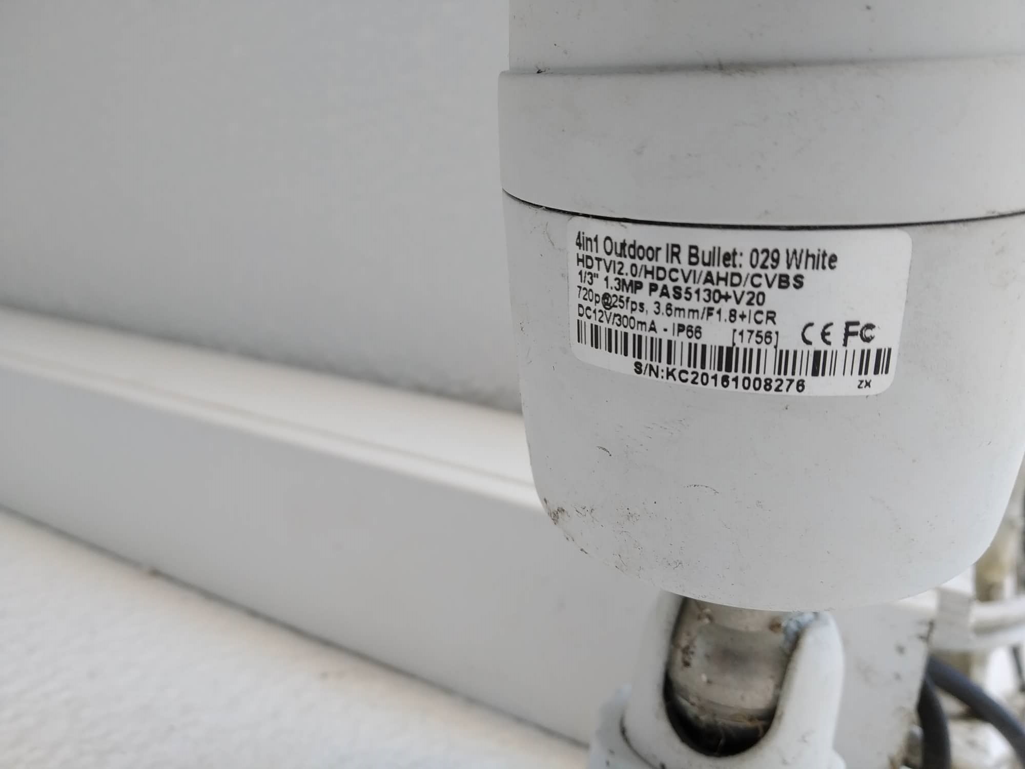

Camera - Information, I see no QR code on it, just that basic information

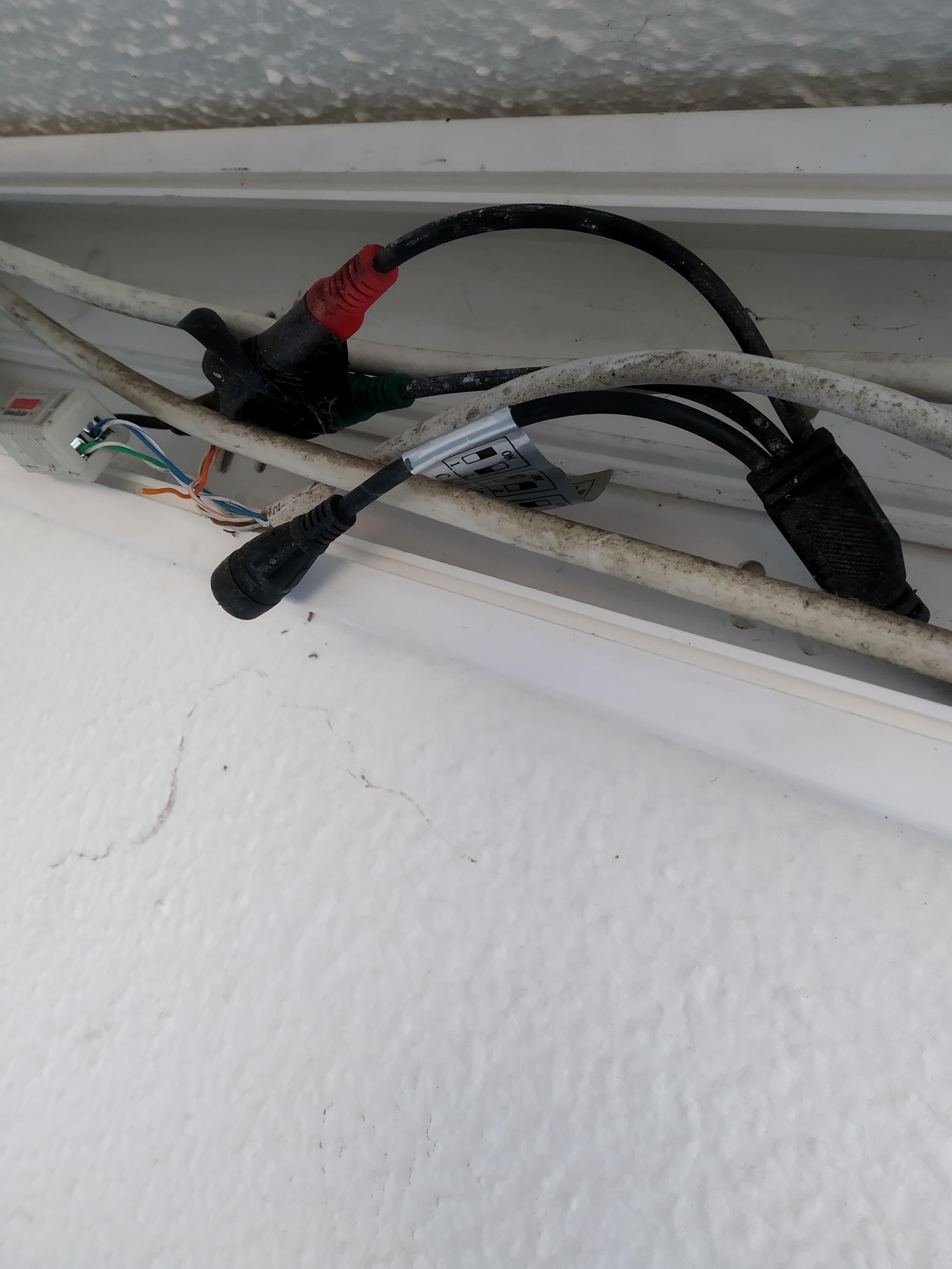

Camera 1- cable-guide-box (sorry, dont know the word in english for this) connectors, camera has black cable that has 3 "exits", 1 is unused, the other 2 are connected somehow to an adapter and than to a R45

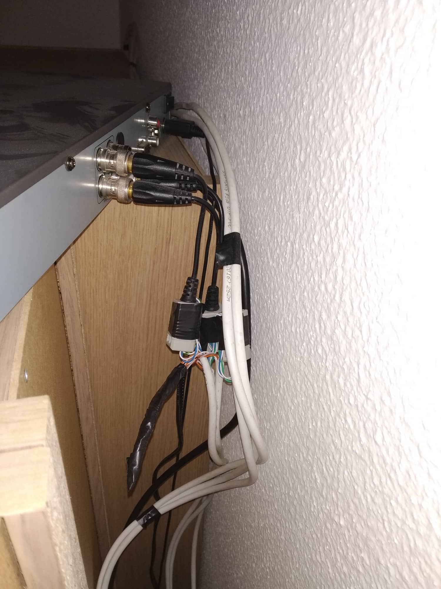

Box back panel where the RJ 45 seams to be re-converted back with some adaptors to a power plug and the connector

The DS-7204HGH-SH is a late 2014 Turbo HD DVR. The cameras are analogue 720p OEM's (possibly made under license of Hikvision) connected via Cat5 Ethernet cable.
Just to clarify, RJ45 is a type of connector used with Ethernet cable, not the cable itself.
Typically analogue systems use RG59 or Siamese cable to connect cameras but it's not uncommon (as in your case) to use Ethernet cable for convenience/cost saving. The adapters you mention are the Baluns.
Upgrading your DVR with a more recent Hikvision Turbo HD Value series is an option and should allow you to keep your existing cameras, provided you have some technical know-how. However, I highly recommend you consider upgrading to IP cameras and a NVR as they offer a wealth of features typically not available to analogue systems.

It should work, but I can't say with any certainty you will be able to simply plug your existing cameras into the new DVR and they will work.
For example, some analogue cameras have a connector with a push button that cycles through the signal settings. TVI/AHD/CVI/CVBS. Check if your cameras have this switch (it's usually a separate cable with a button). If not, you may struggle to connect the cameras to the new DVR.
Even if the switch is present, it's hard to tell how long the toggle switch needs to be pressed to cycle through the settings. My point is, you may run into complications and find support is limited for your OEM cameras. It's also possible they will connect without any hassles. It's hard to say.
