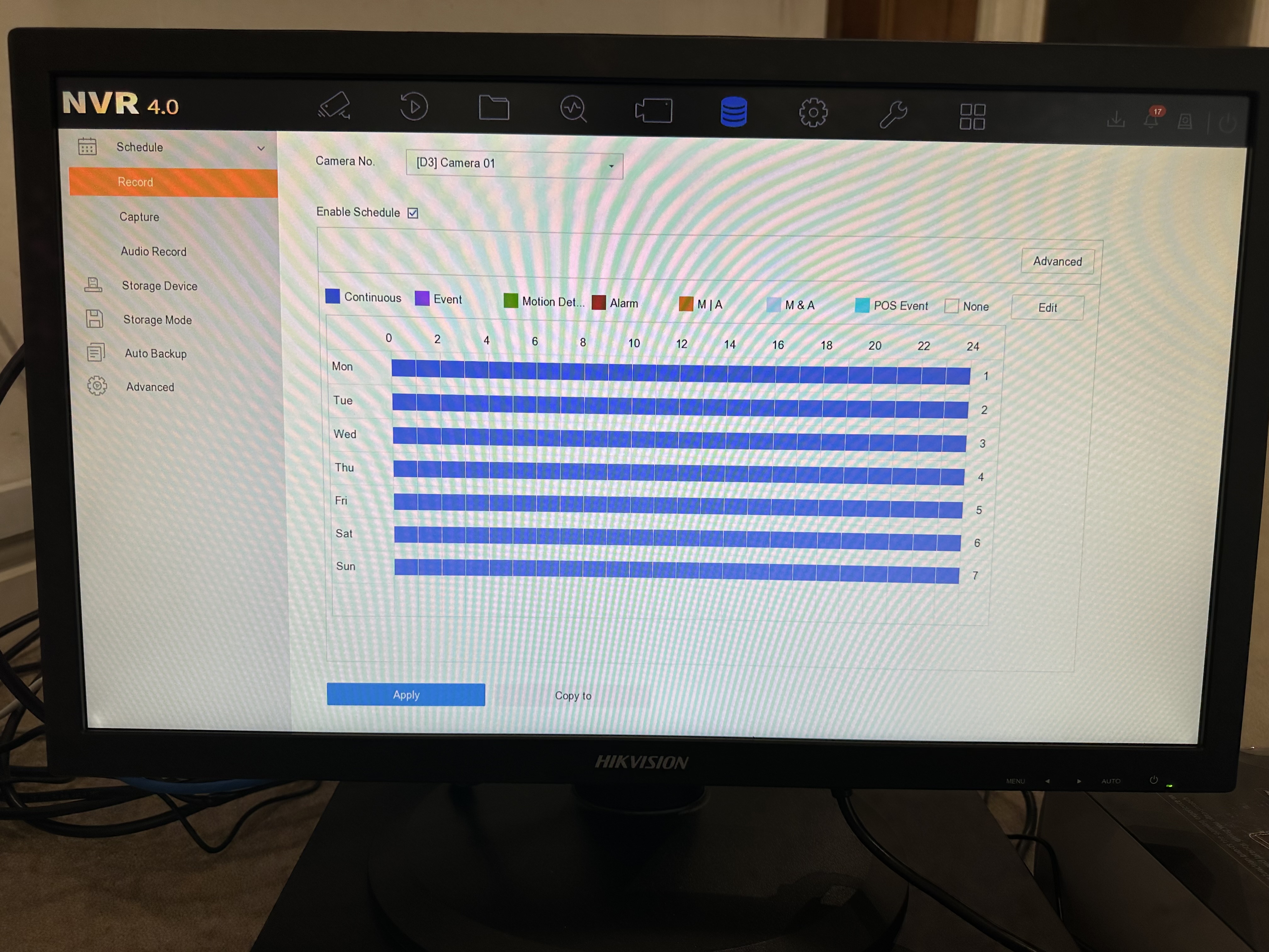

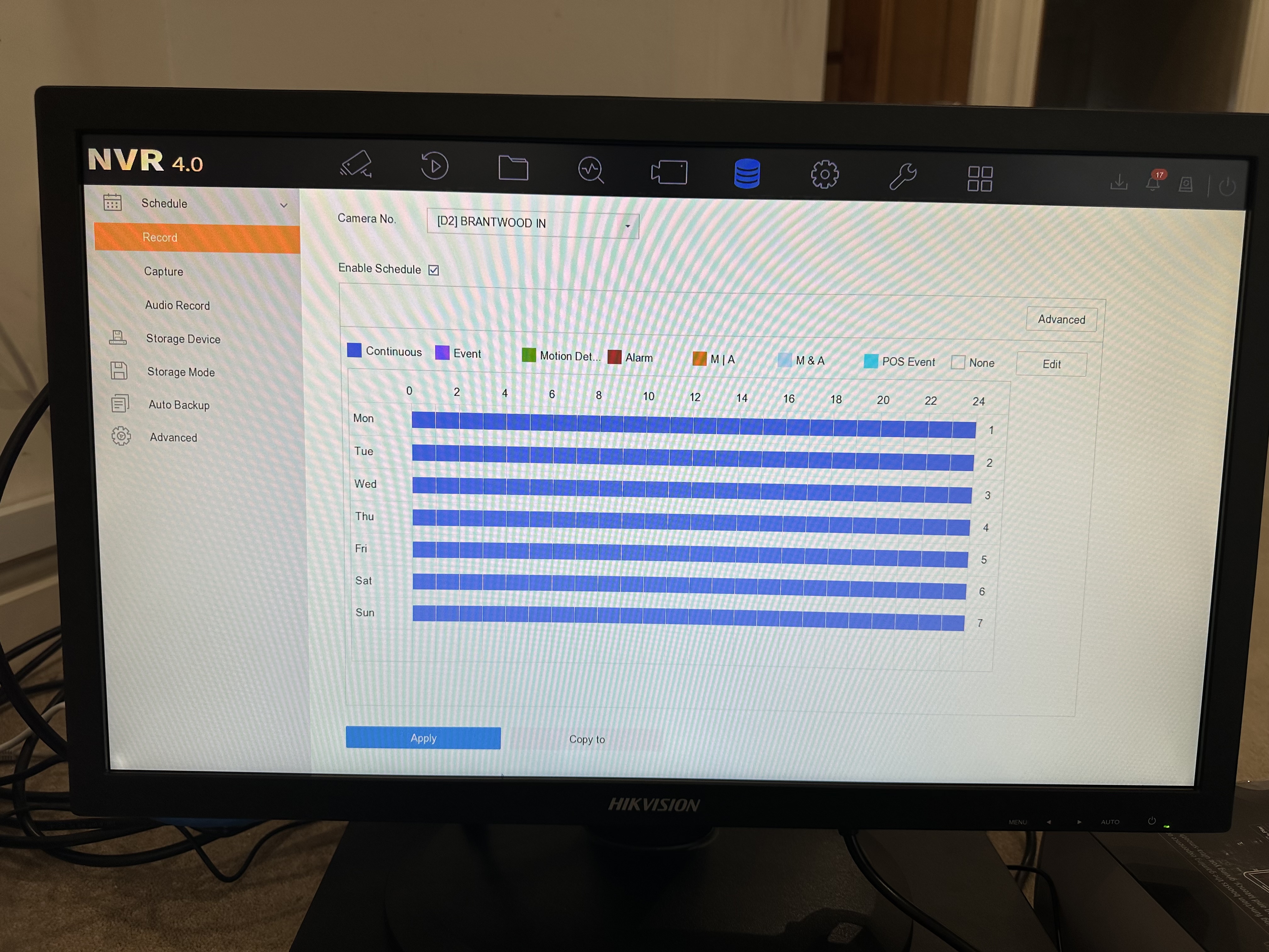

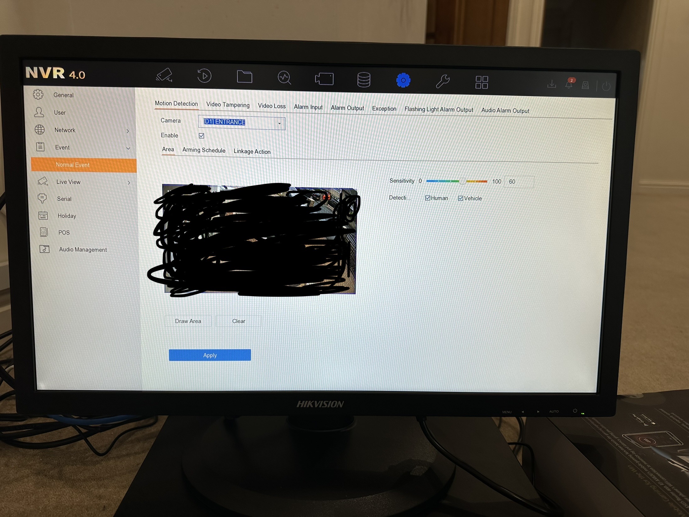

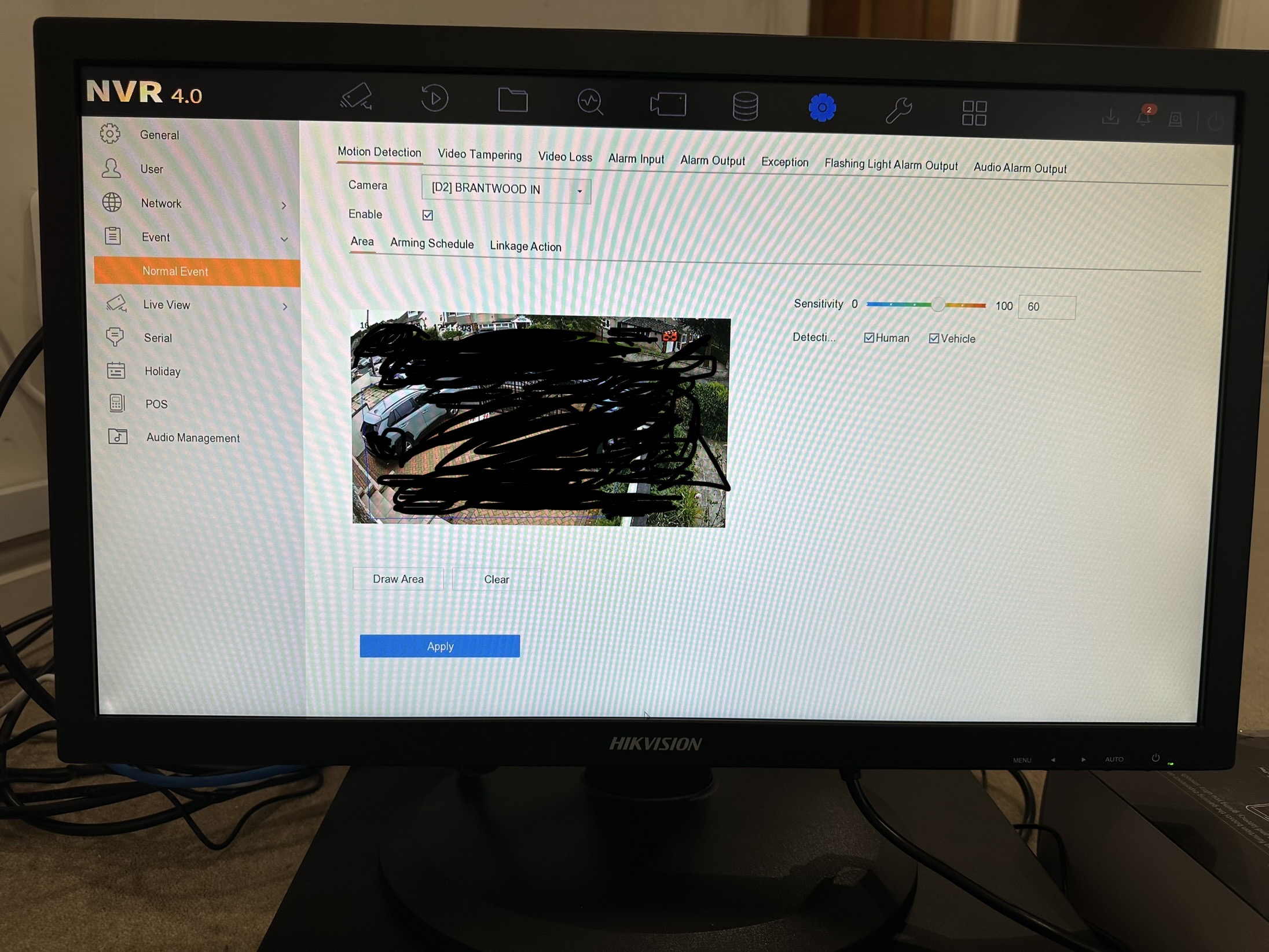

I have checked the above and each camera has the schedule set to Continuous recording (see pic below for one of my cameras) but still have the issue in that when I reboot the NVR or does not start the recording for each camera so I have to Start recording on each camera manually.
Also, under the Event —> Basic Event config for each camera (see second pic as example), Enable Motion Detection enabled which shouldn’t cause my issue as this is set the same on my own NVR and recording works fine even after rebooting.
As a test, I did disable this but still have the issue.
Therefore, can you please advise what else I can check as to why recording of each camera does not start after rebooting NVR.

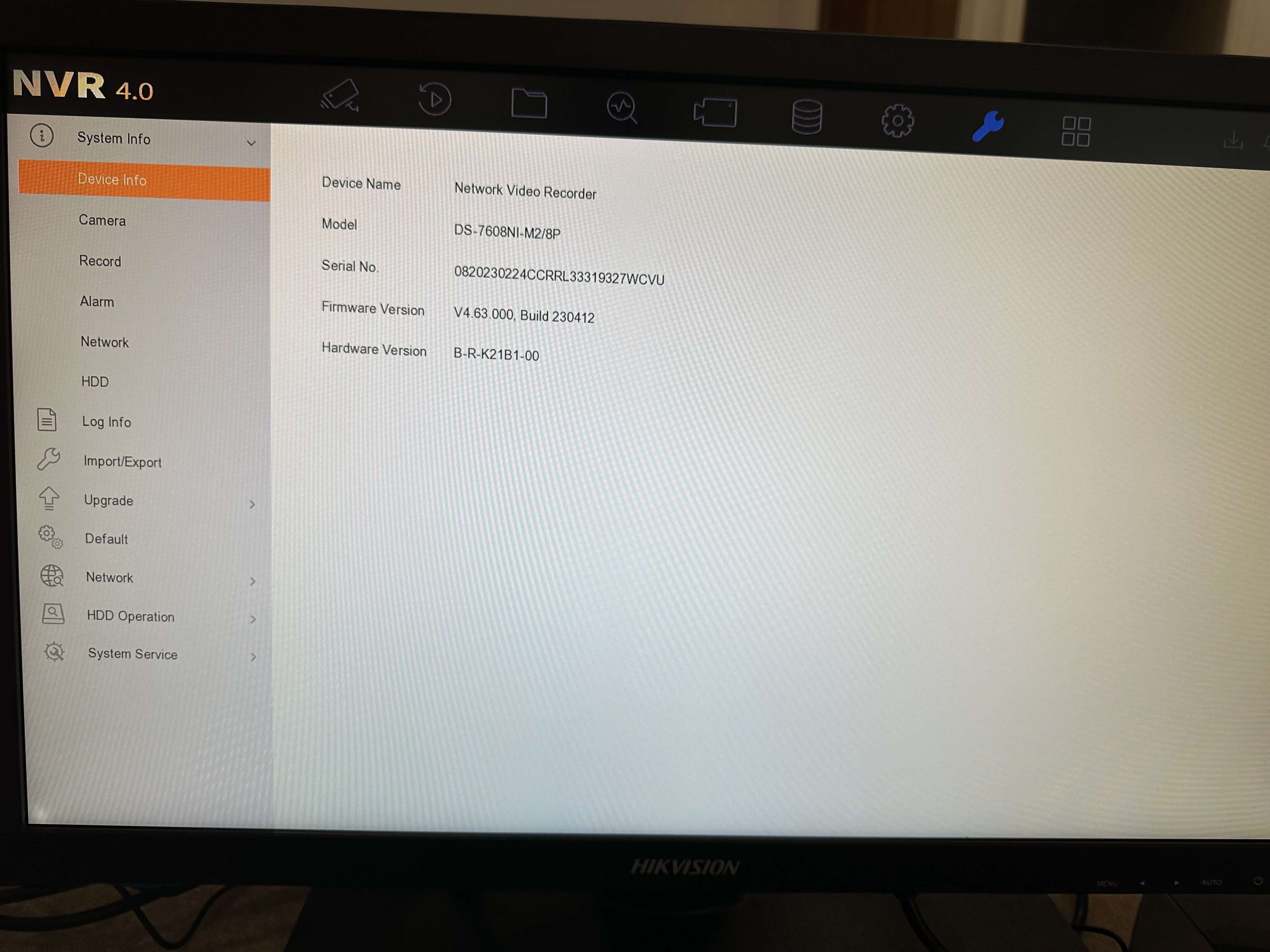

Sorry for the misunderstanding looking at the two screenshots I sent - they are from my own NVR to show you the config settings which are exactly the same as my daughters NVR - the reason why the Luca show the same ip range is that the camera is connected to a seperate Switch and was added through the SADP tool so please ignore the ip Config bit on these pics.

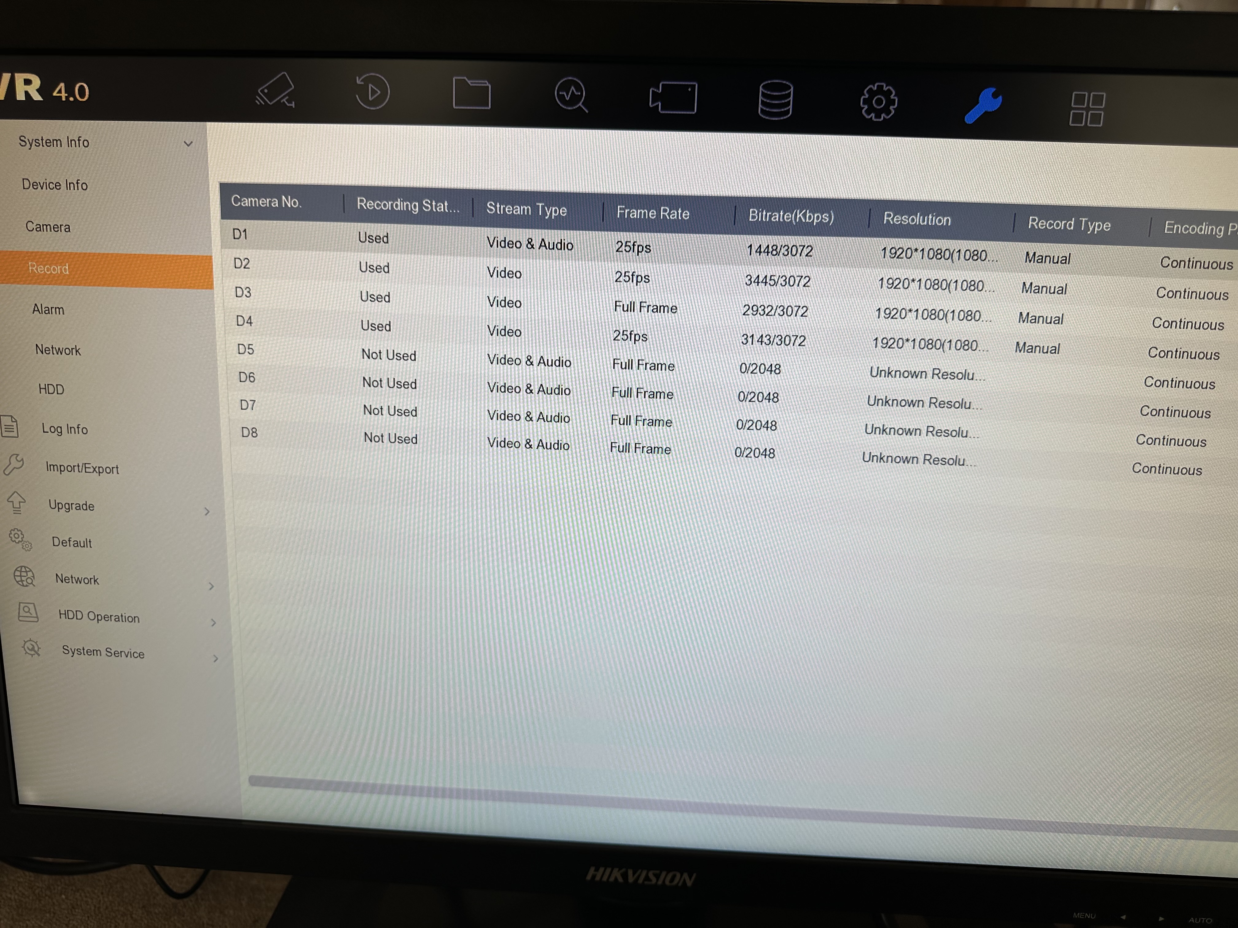

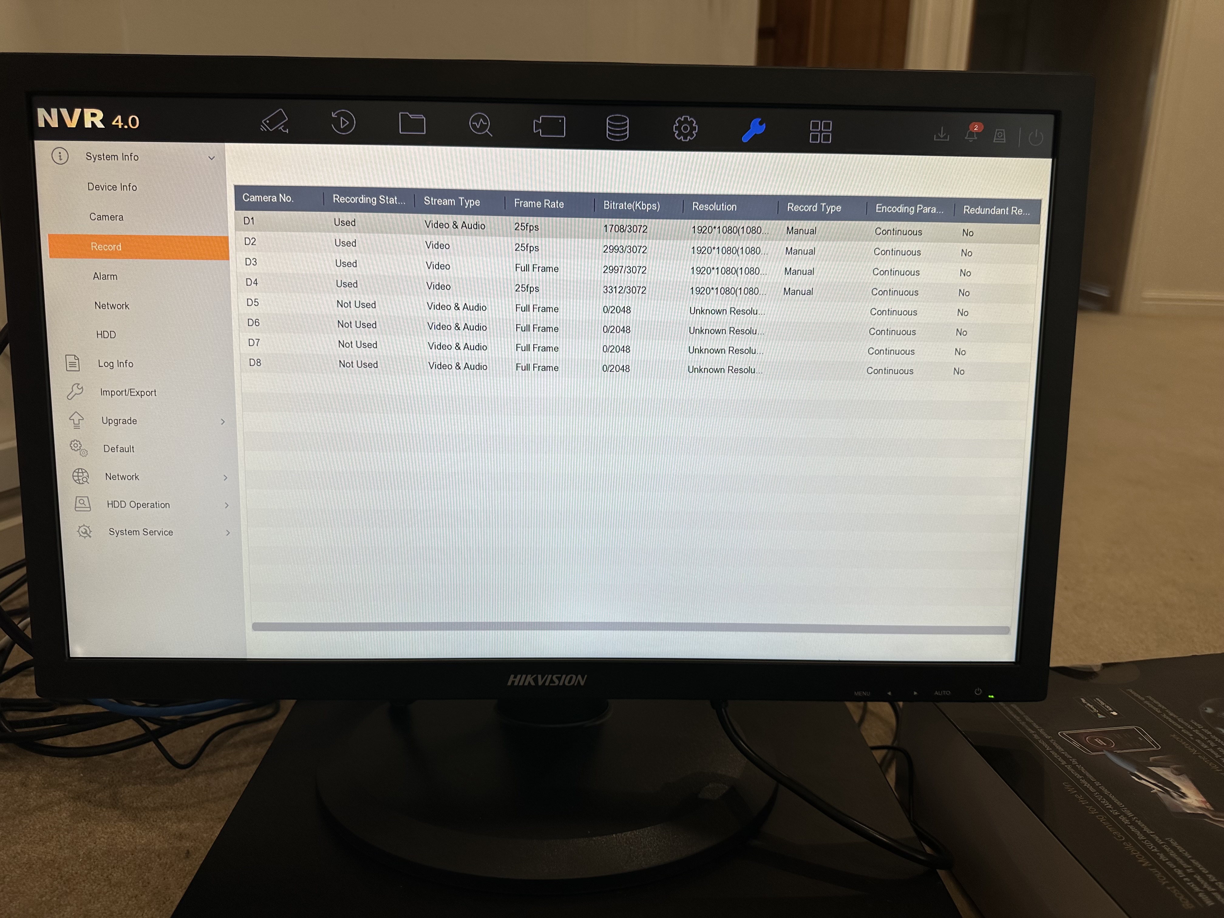

Just another bit of settings I’ve noticed.
If I go into the menu settings direct on the NVR, the Record setting is set to “Manual” instead of “Continuous” which is the case on my own NVR (DS-7608NI-I2/O2). - see pic
Could this be the issue as I cannot find how to change it direct on the NVR menus.
That's showing how the cameras are currently recording, so if the NVR rebooted and wasn't recording, then you started manual recording, it will show 'manual'. If all was well, as soon as the NVR reboots and the cameras connect it would show 'continuous'

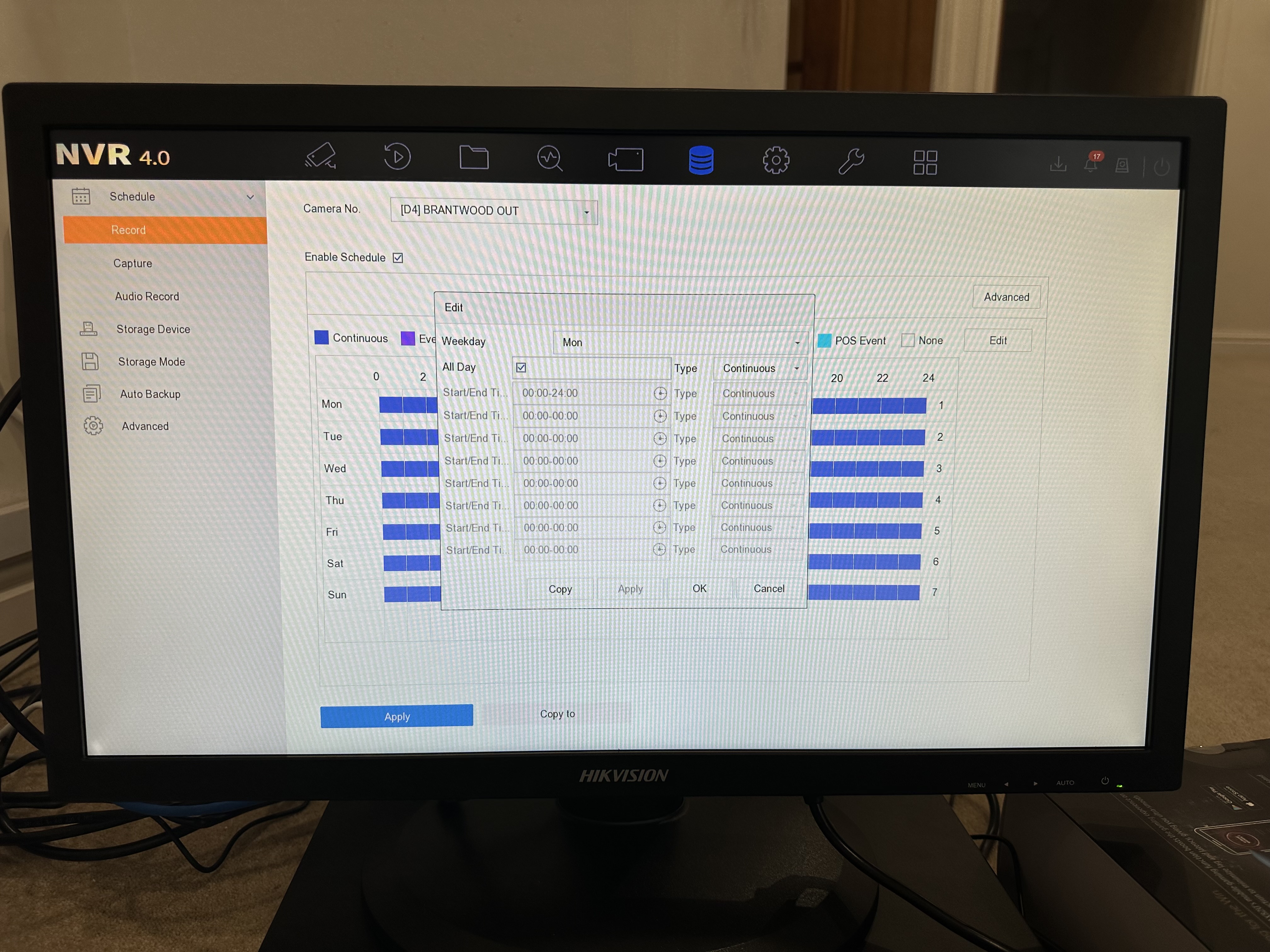

Show images of the record schedule on the affected NVR. It should be enabled for 24/7 continuous recording for all cameras. I know you've said it is, but the previous screenshots were of your own NVR as an example as opposed to your daughters which has the issue.

@kmb76 - Only the NVR is relevant. You could have anything you like in the individual cameras and it will have zero effect on recordings. Your cameras are managed by the NVR. The NVR recording schedule should be set to 24/7 continuous and enabled for each camera (which it would have been out of the box)

3. The recording schedule is again configure through the web gui on the NVR and selecting each camera setting.
That’s correct. I can only imagine that this is where a mistake has been made. All of the bars should be blue for continuous. Clicking continuous has no effect on its own. Clear the schedule, click continuous, set the first day to 24/7, save, copy to the other days, save, copy to all cameras, save.

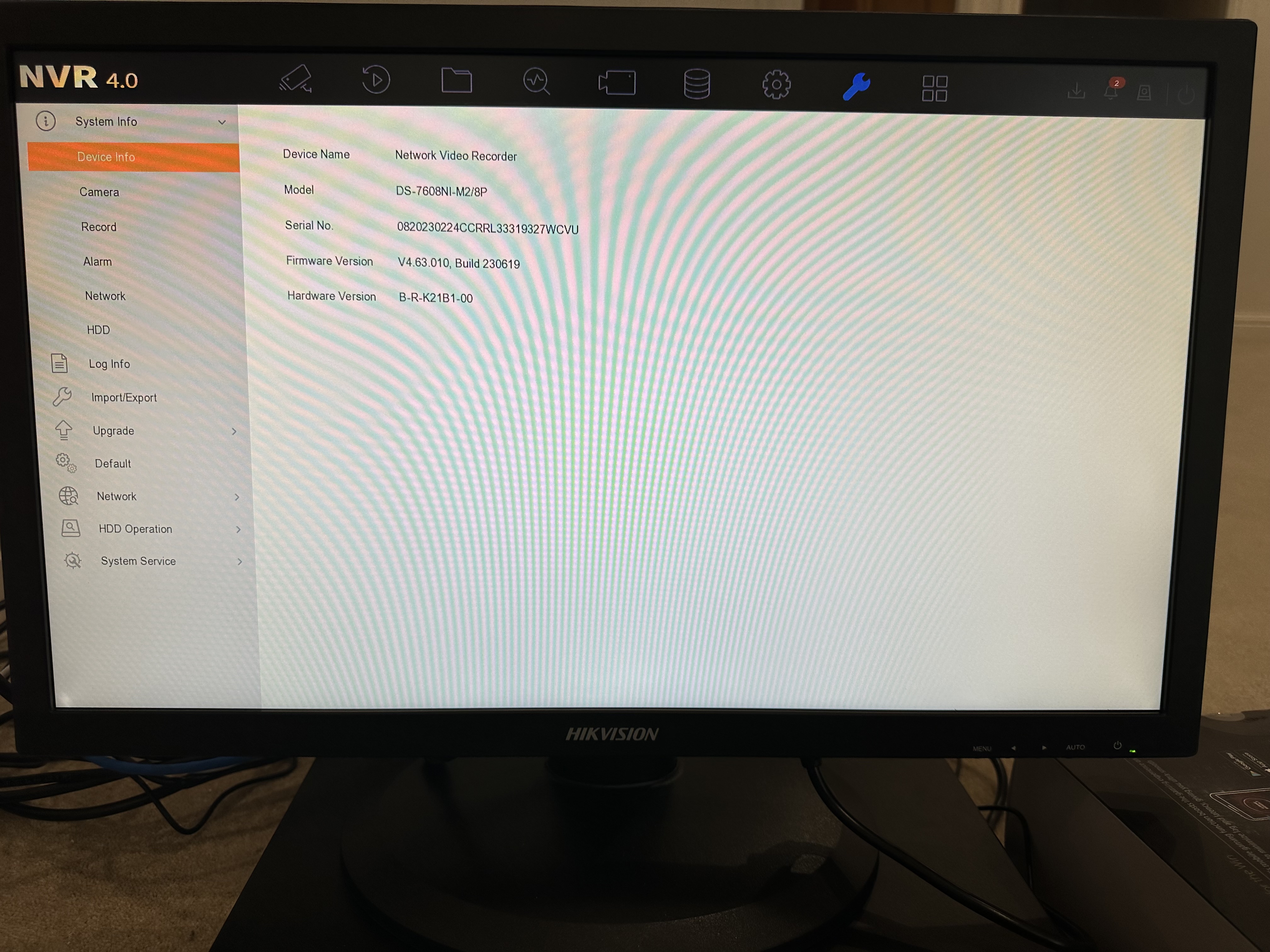

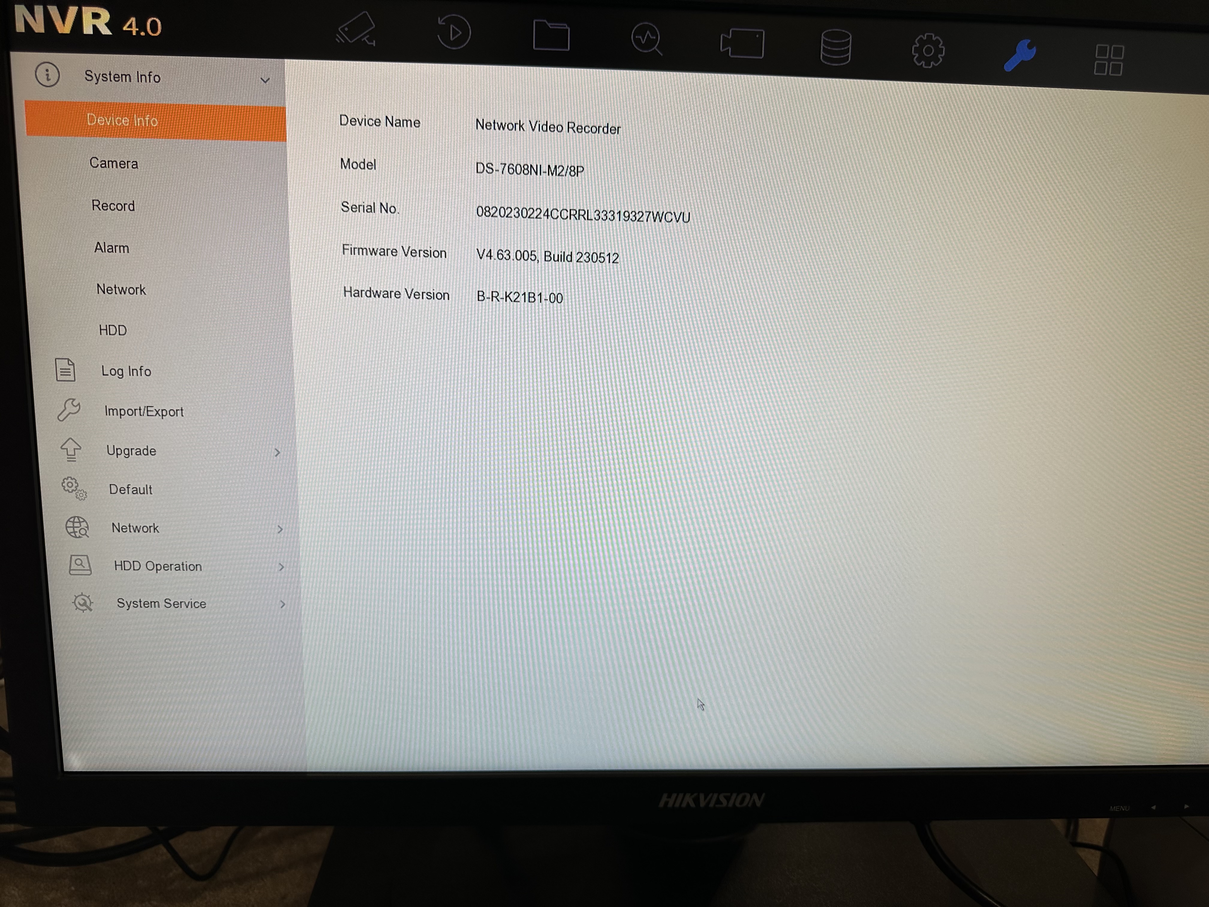

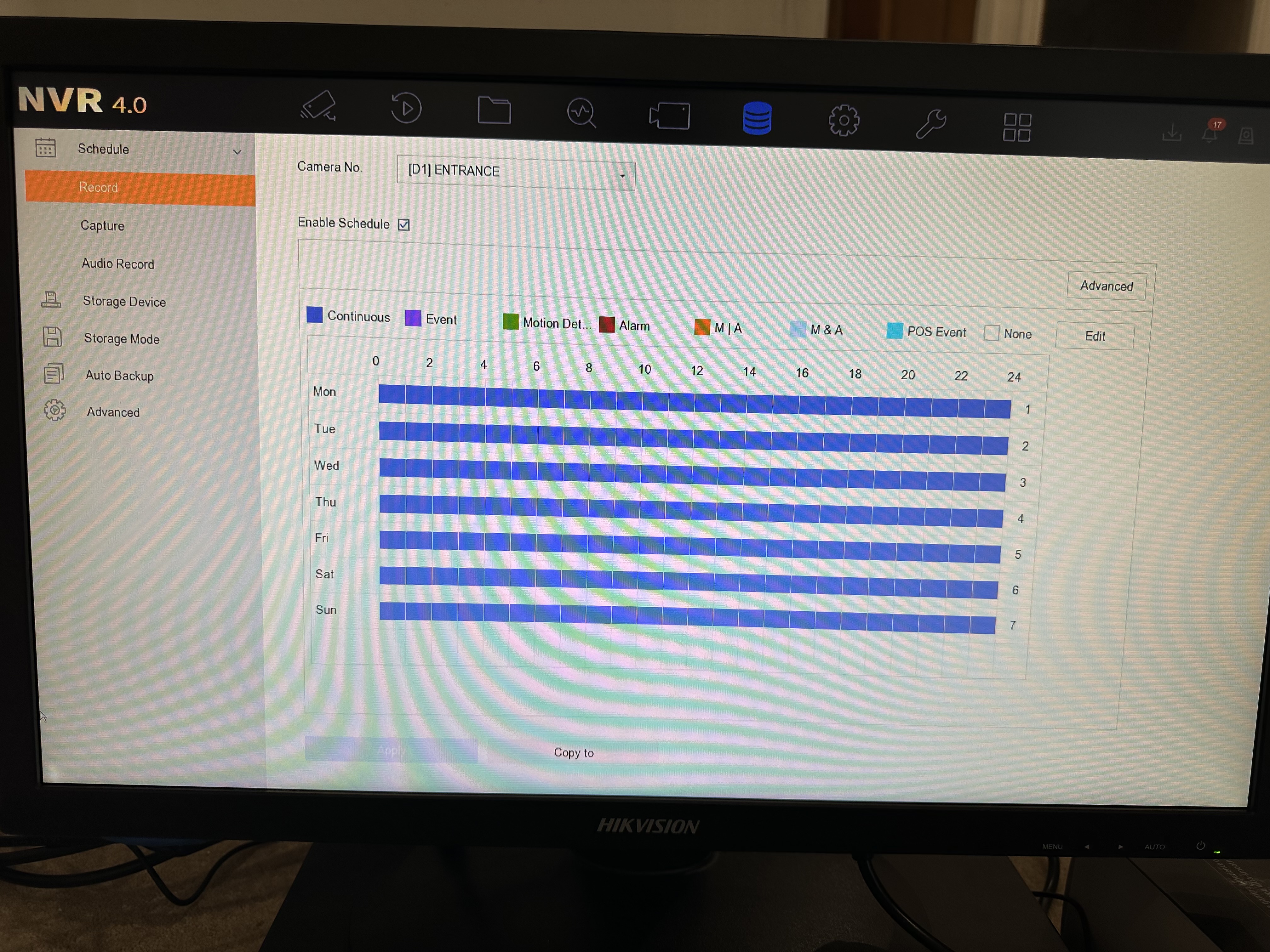

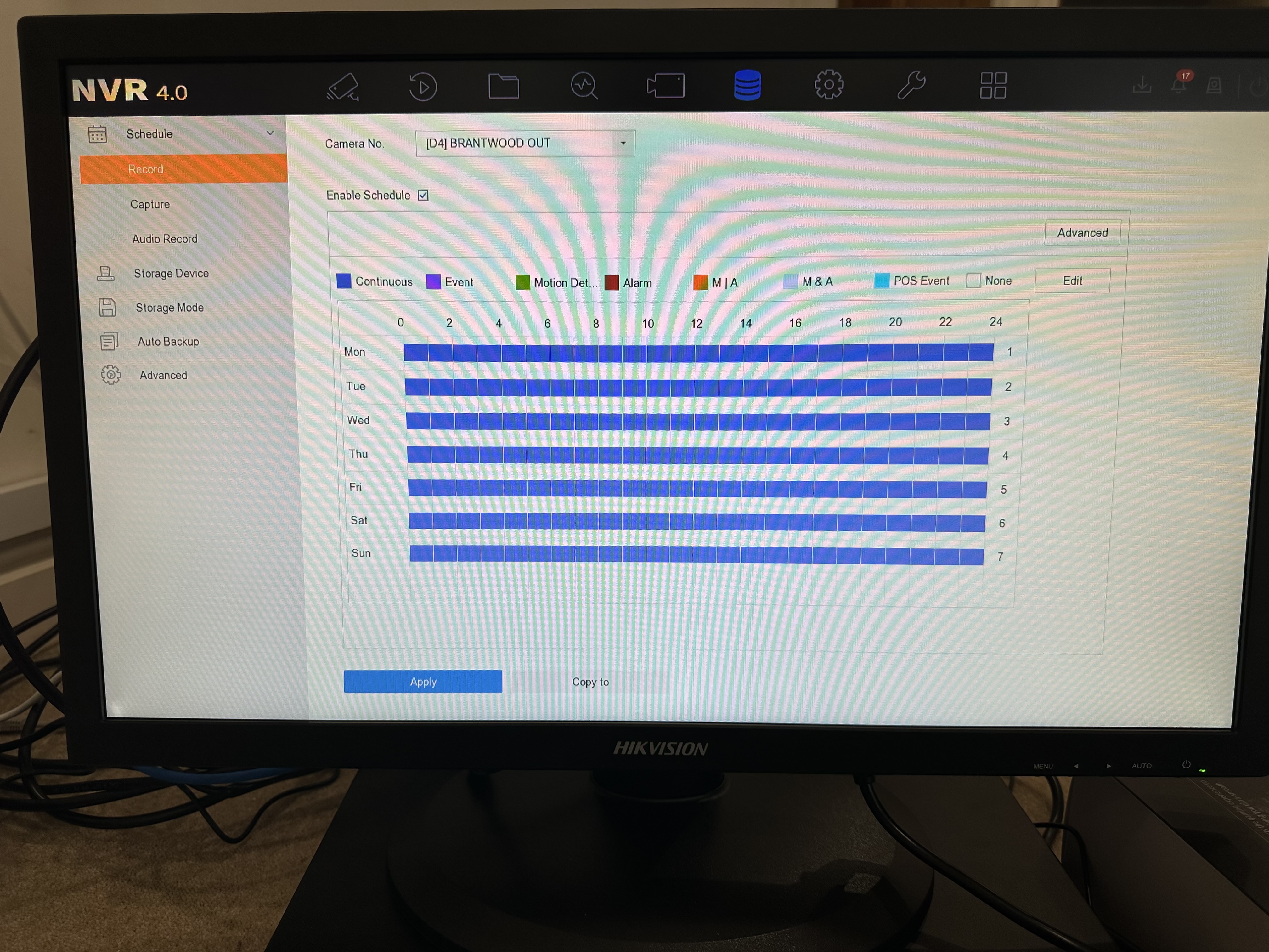

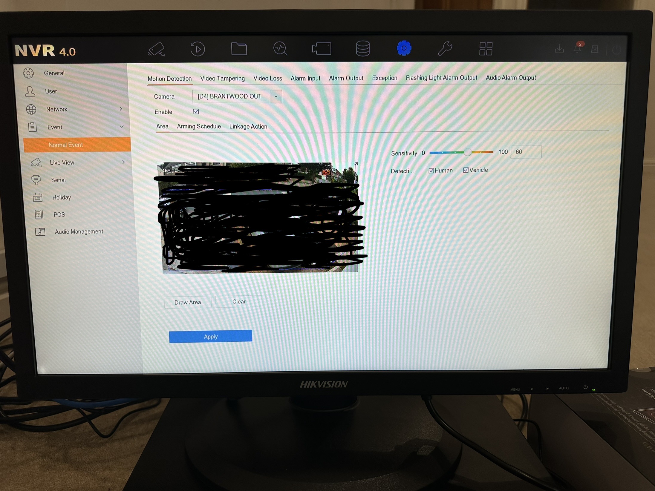

I have managed to spend some time today to check out various settings and installed some more firmware updates. Details below.
1. Rebooted NVR and BEFORE “Starting” the recording on each camera, I got my daughter to go out in front of the cameras and I could see inside on the screen that motion detection detected movement and recorded this as I could see this clip in playback. However, after still leaving the recording off for a while, it did not record any continuous recording which is very strange.
2. The current firmware I installed once out of the box was V4.61.420, Build 230217.
I noticed that there were three further firmware updates released which I have installed one at a time successfully but issue not resolved.
3. I have disabled/enable motion detection on each camera.

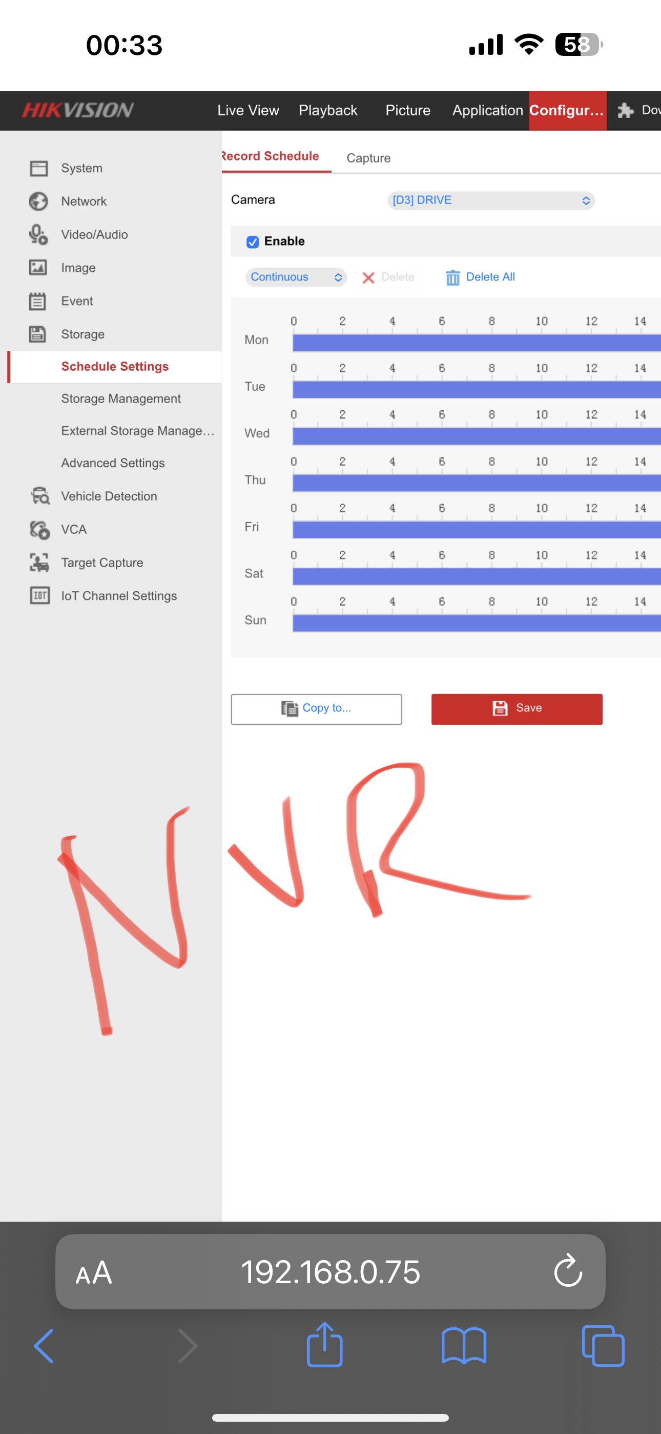

4. I have cleared all record schedules on each camera and then set continuous schedule on one camera then copied to all days and all cameras.
After testing all above steps, still have the issue. I attach screenshots of the firmware versions after each update, record schedule settings and motion detection settings.

Everything looks to be as it should and I see no reason for the schedule not to work. If there were a specific firmware issue, that would've been resolved by the updates (my own NVR has the same version on). Just check that in Configuration > Storage > Advanced Configuration > 'Others' that 'Overwriting' is enabled (all three checkboxes should be ticked) That's in the browser menu so you can do it remotely.
What I'd probably do next is to reboot the NVR remotely, give it 5 minutes to come back online and for the cameras to reconnect, then log in remotely again. Once logged in go to Configuration > System > System Maintenance > Log. Change the start time of the log to just before the reboot and see what goes on as the cameras reconnect - do the logs show any exceptions/warnings that may give a clue as to what's going wrong?
I can't think of any setting that could be misconfigured directly on a camera, that would prevent the recording starting while allowing live view and an otherwise working system. In the absence of any error in the NVR log above, I'd factory default one of the cameras and reconnect it using Plug and Play without altering any settings. Once connected a further reboot to see whether that individual camera starts recording as it should would confirm whether this is a NVR or camera config issue.

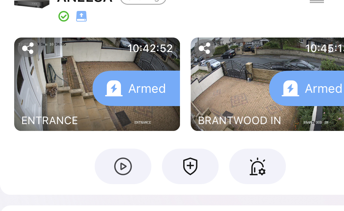

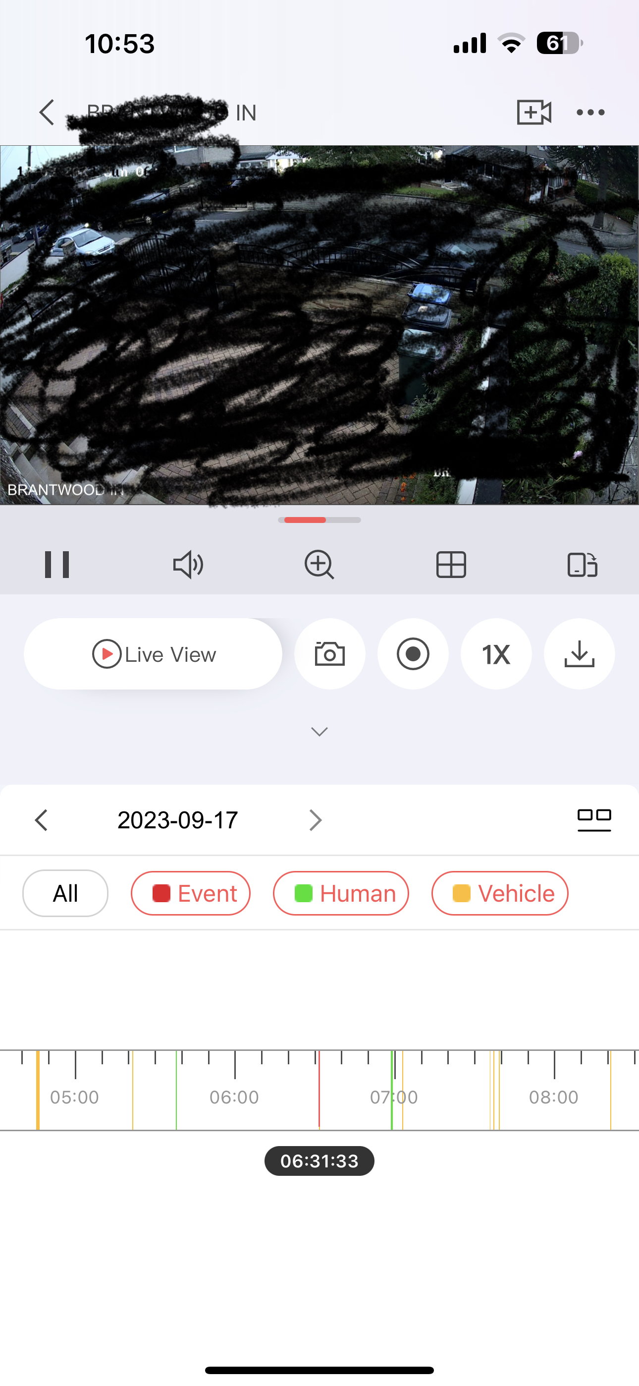

Another odd thing that I’ve just seen this morning when using the Hik-Connect app to view the cameras live - since all firmware updates have been installed on NVR, there is a pop up on each camera screen that says “Armed” and when I go into “Playbsck” on each camera, it seems that it is only recording motion/event clips and allows you to click on All, Event, Human, Vehicle playback events which is new and it is not recording any Continuous recording. See screenshots attached which is quite odd now.
