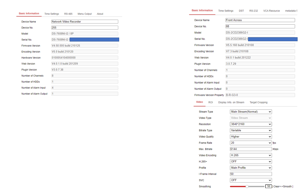

Hi. I have 7608NI NVR per attached with 7x cameras to PoE on it. Cameras are mix of 2x 2032 and 2x 246G2 and 2363G0 and 2363G0 and 2386G2.
In tweaking the 2386G2 based on posts on here I set bitrate =12,288, bitrate = variable, and video quality = highest.
I've noticed however that without my intervention when I go back to the Camera the above settings are changed to bitrate = 6144 and video quality = higher.
A similar thing occurs when I change video quality to medium in that it goes back to higher !!! Driving me mad as the 12,288 is ref'd on the HIK card as well.
Q: Why do the settings revert back after i have changed and they appear to have been saved?

I have had settings revert on Hikvision cameras too, mainly the Max. Bitrate settings of the Main and Sub streams. Welcome to the wonderful world of HikVision...
I have found a couple of possible reasons/causes for this behavior so you could look into these:
1) First I would try setting all your main/sub stream settings on the NVR itself. And I mean directly on the NVR interface NOT via the web browser interface of the camera or the web browser interface of the NVR. That sorted out some of my issues.
2) When I go to the web browser interface of a camera I see only two streams (Main Stream and Sub Stream) BUT when I go to the camera remote config interface on iVMS-4200 Image -> Video/Audio I see an additional "Event Stream". I THINK that when iVMS (or camera? or NVR?) gets an event (say a motion event) it temporarily changes the main stream settings to these settings! So I just ensure the "Event Stream" settings are set to the same as my Main Stream settings to avoid any of these event changes.
