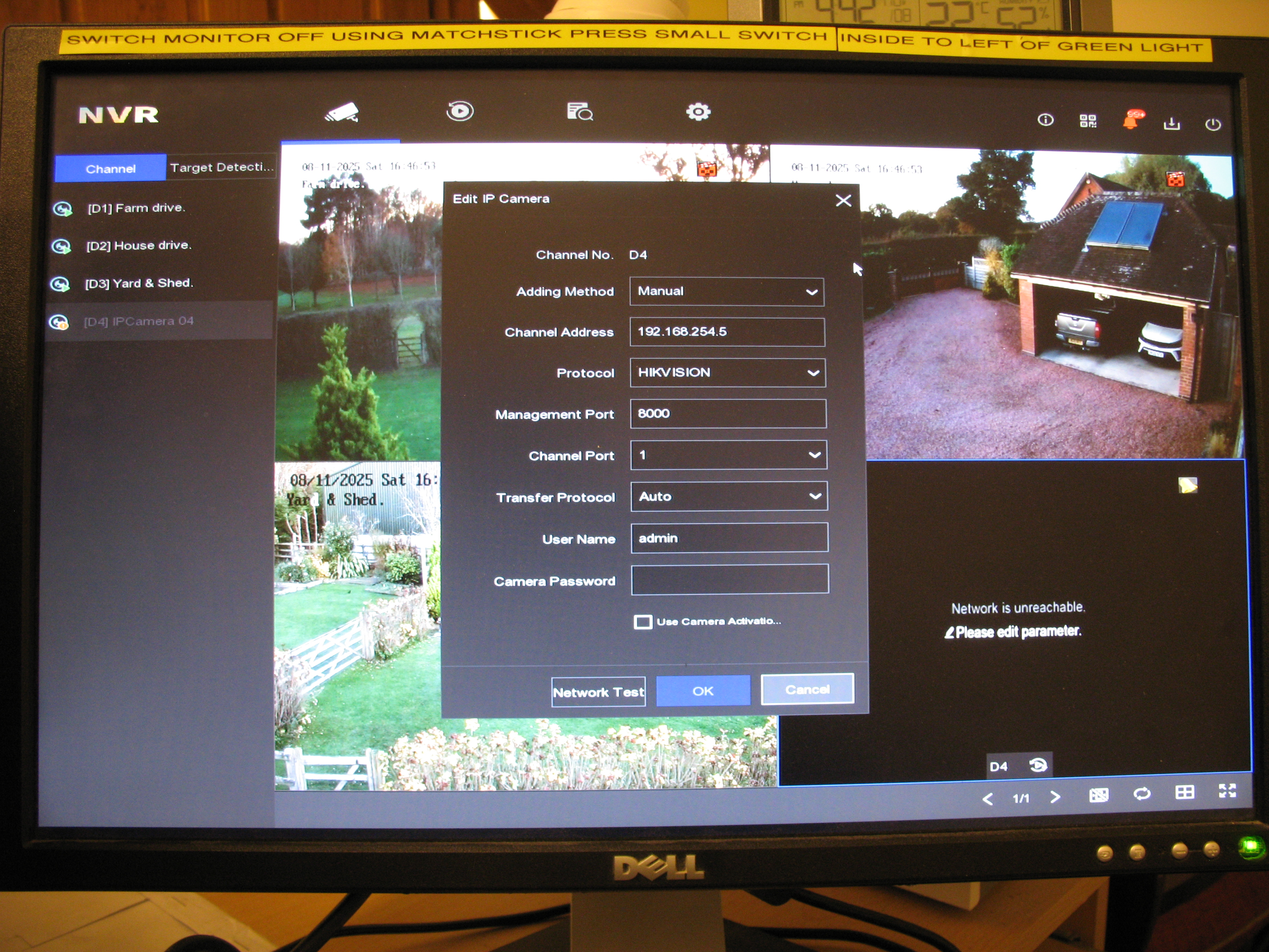

Sorry Gents, it's me again ! I plugged the camera into the NVR and the following were the results. Firstly, this is where I got to on my stand alone monitor :
I clicked on the Camera Password box and then tried the 2 sets of numbers on the keyboard that appeared and pressed the return key that is on the same keyboard but nothing happened.

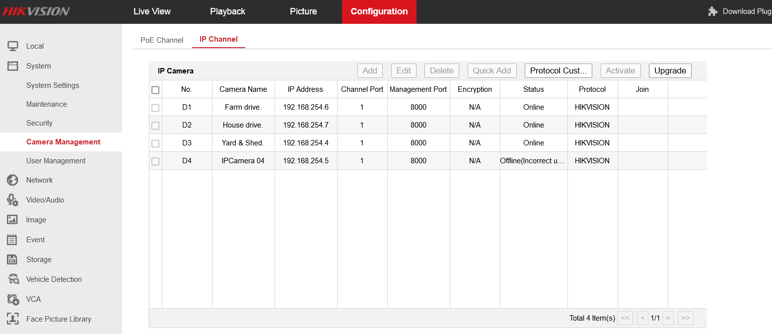

I then logged into the NVR from my desktop pc and got to here and then tried lots of the options but I couldn't seem to get anywhere.
Could anyone possibly help please ?
