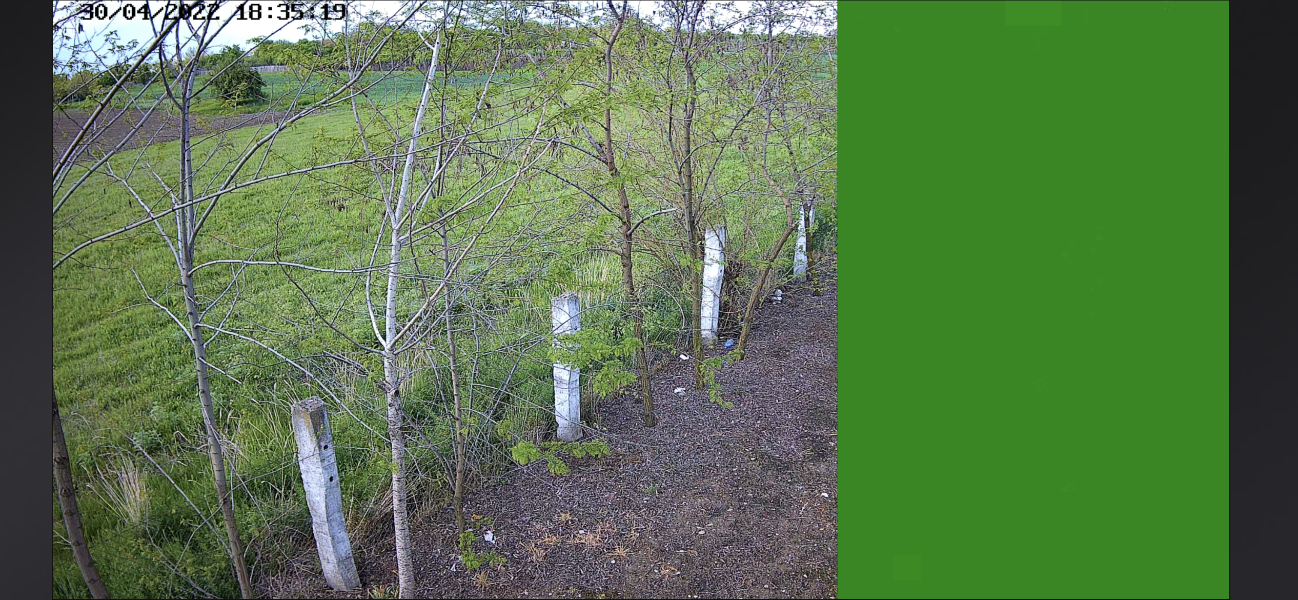

After updating the Hikvision NVR DS-7732NI-I4 (B) (to version V4.60.005 build 220108) I started to have the following problem:
- randomly, the image on some cameras freezes and a green spot appears. (I didn't have this problem before the update).
Can anyone help me with a solution? or with the previous firmware version for DS-7732NI-I4 (B) to downgrade (I can't find previous firmware on the hikvision site).
Thank you
