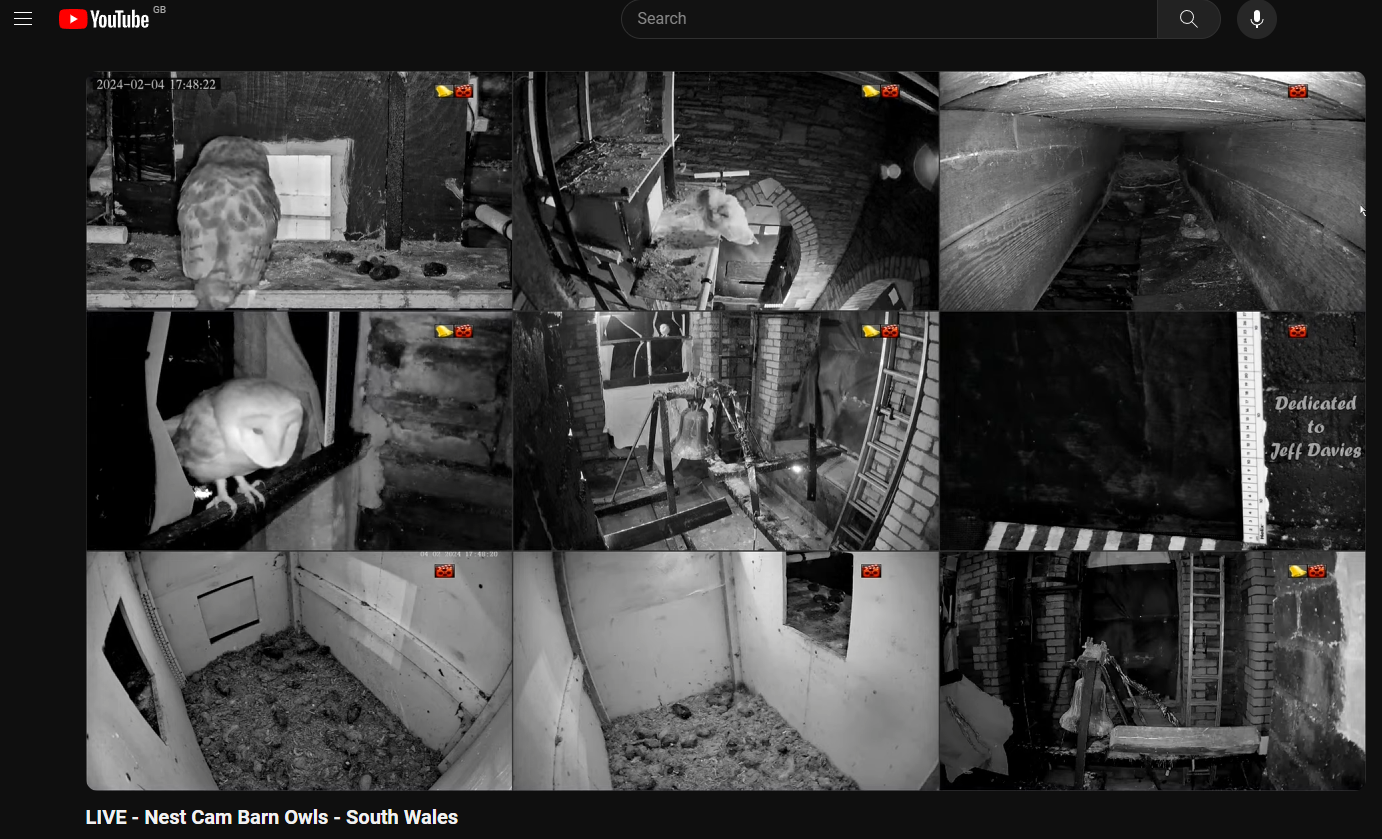

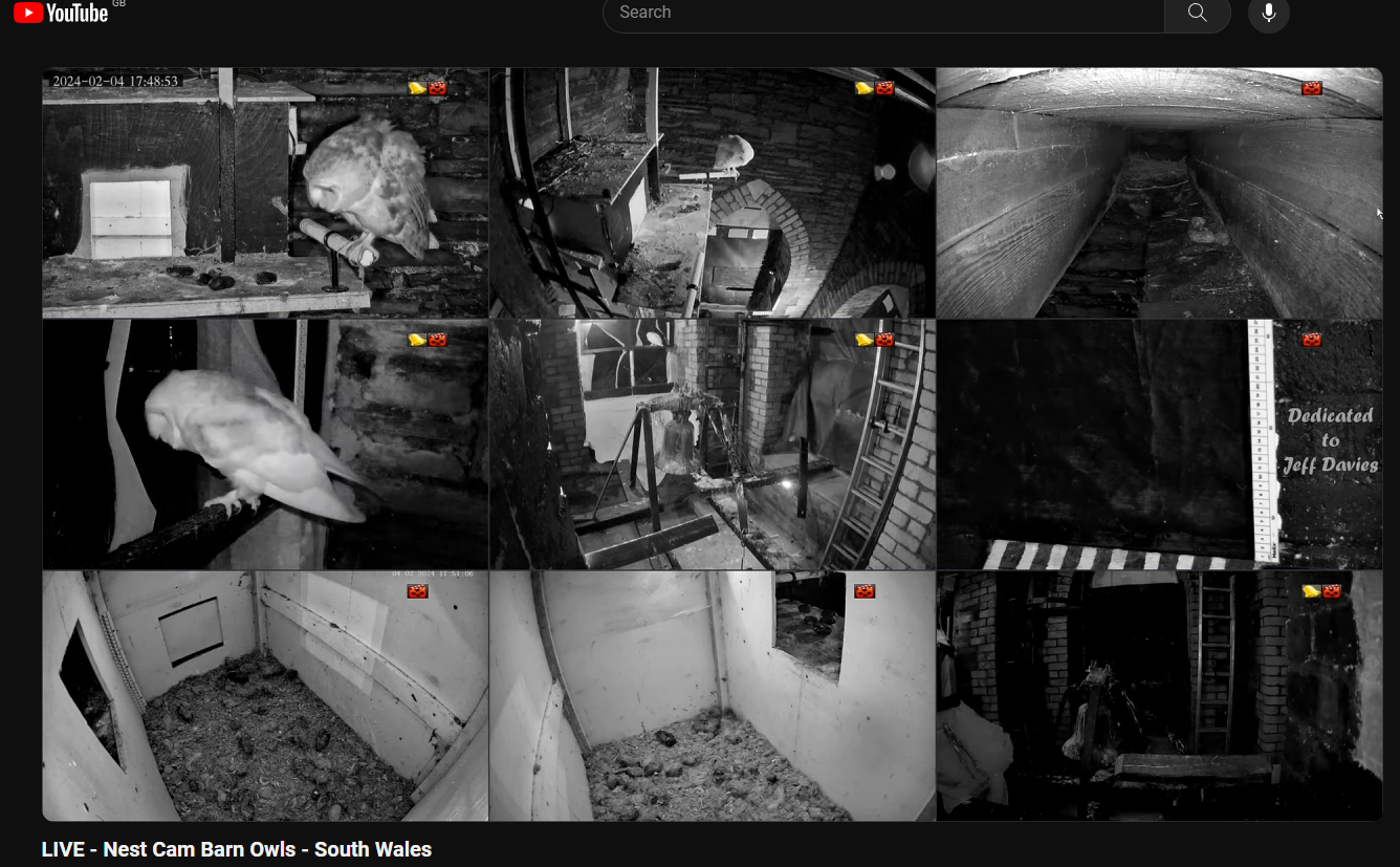

A couple of screen grabs from earlier:

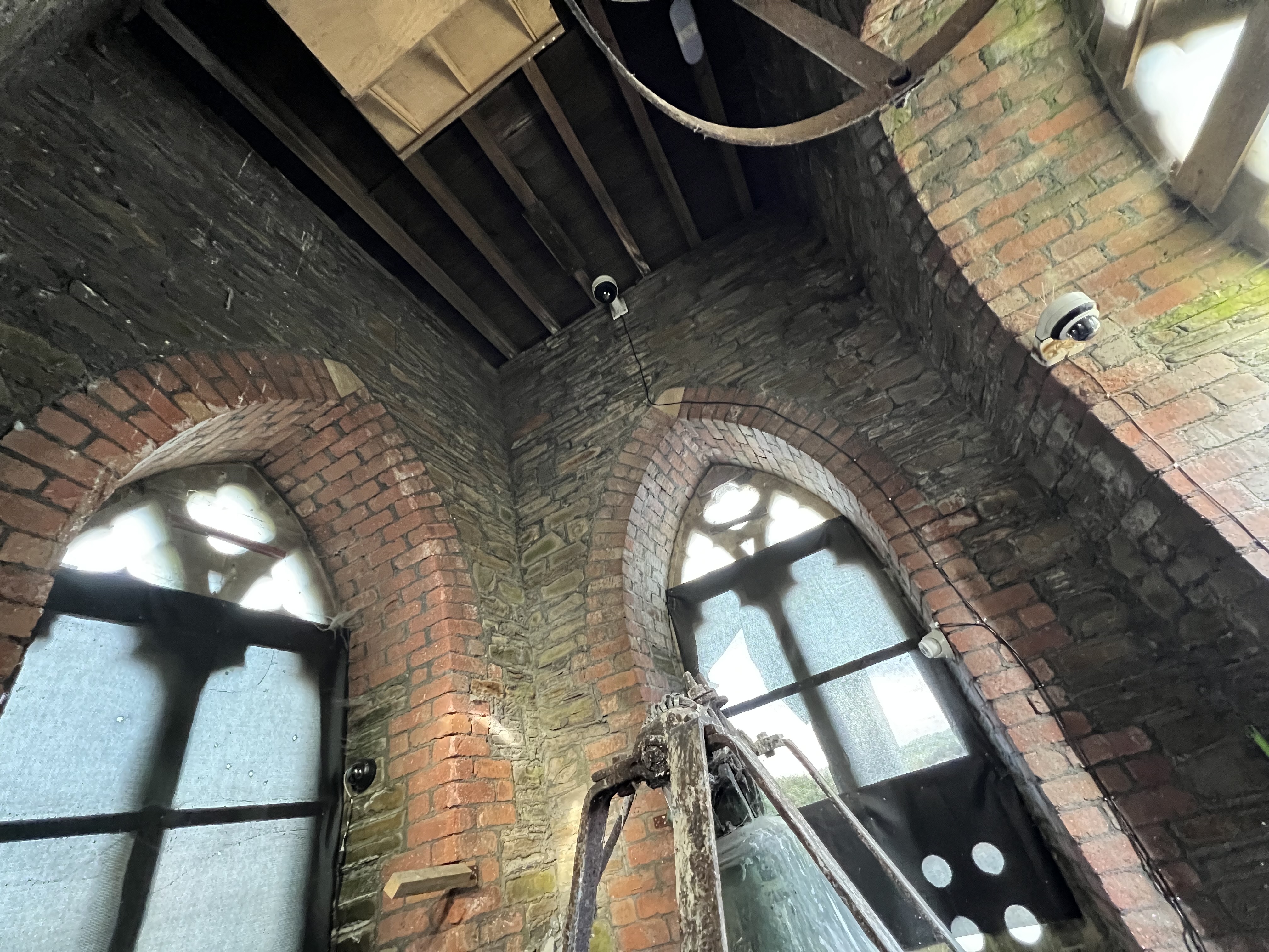

1 x camera looking at the bell - £150 (We chose a budget Hikvision PTZ for this so that we could look around the tower, and zoom in on the owls)
1 x camera in the owl box - £100 (A miniature camera about 1 x 1 x 1 inch powered by POE)
1 x camera looking at the owlbox (A second hand donated fixed turret Hikvision camera)
1 x POE switch- £50
Network cables/tools/plugs - these cameras are at the top of a church tower with no power - so I ran a network cable from the groundfloor for each camera feed - used a 305m box of cable plust plugs/socks/tools - about 30m of cable for each camera run - probably about a £100 all-in

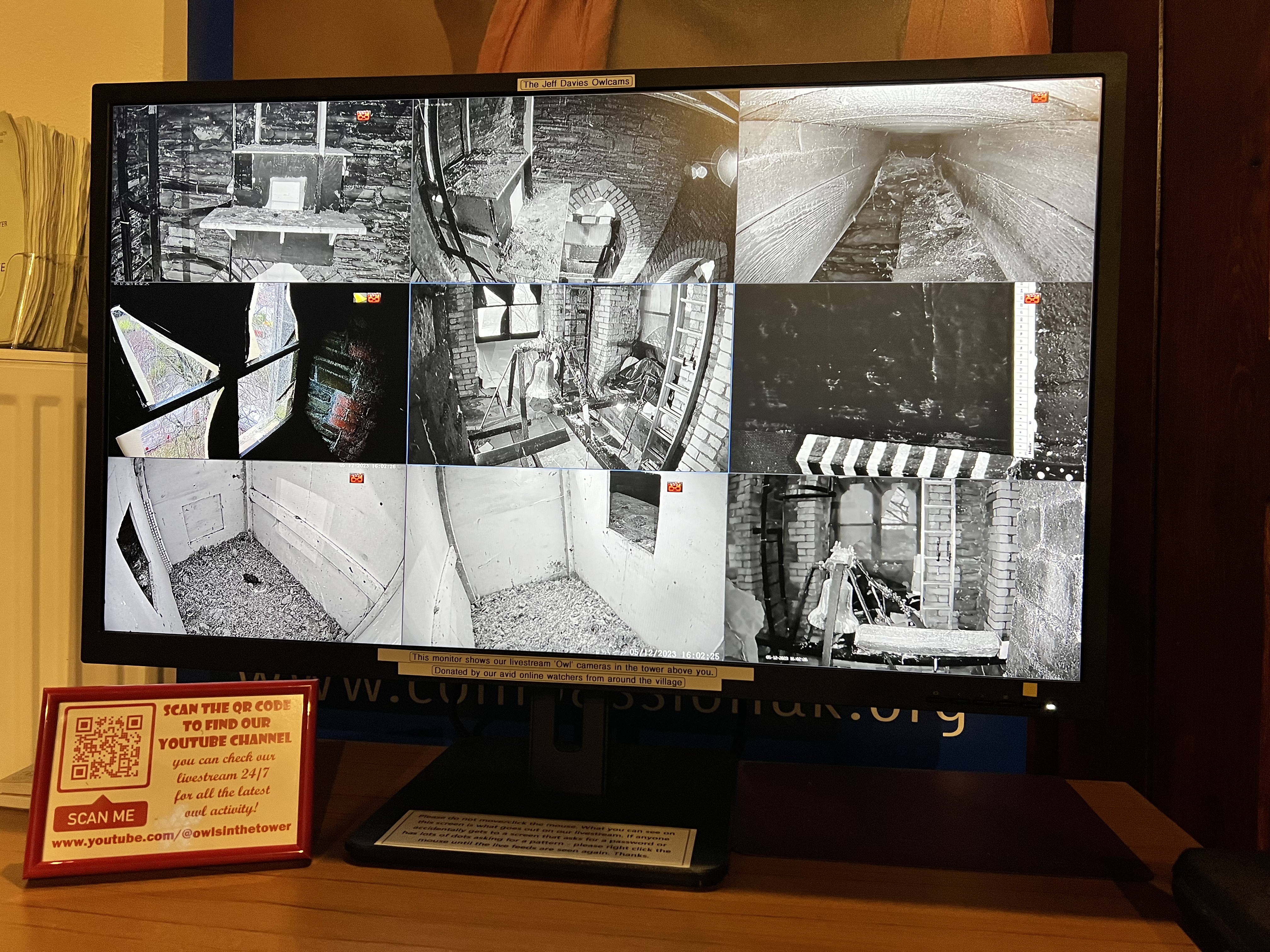

Initially interest was limited to a few comments and likes, but when the eggs arrived, the whole thing took off. By the time we'd been through the egg cycle of 6 eggs, 4 hatching and 3 owlets surviving, the interest was much greater. At this point we crowdfunded for a 32" monitor to display the owl cams directly at the back of the church. (The church is used a bit like a village hall - everything from young farmers to slimming world hold meetings in there). I also received a further donation to expand the number of cameras, and a donation of some 'used' equipment from a local CCTV company (if you have one - they can be worth approaching - that in return for a mention in your facebook posts - they might want to donate an old network video recorder and a couple of used cameras)

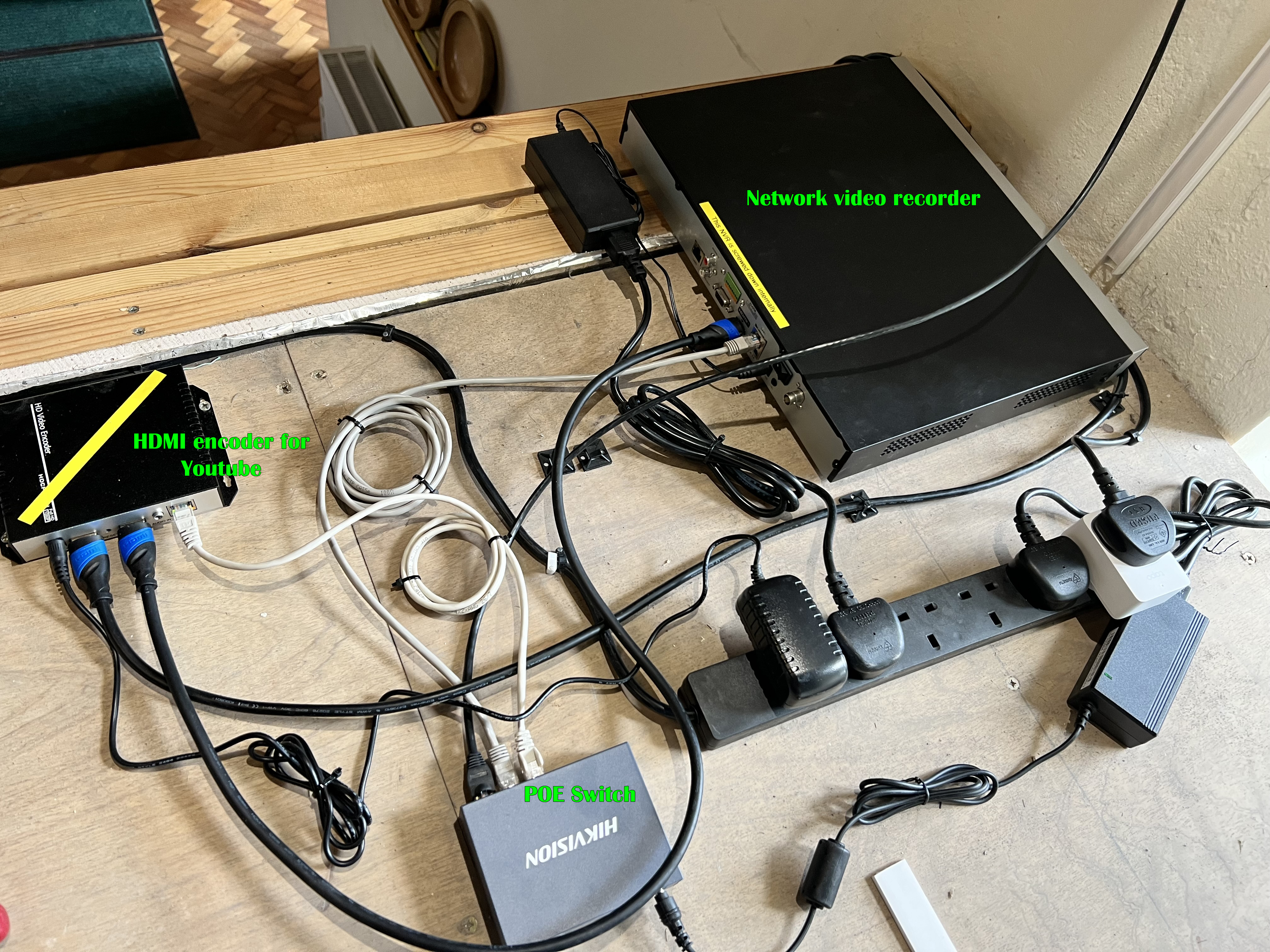

Dedicated Hikvision 16 channel network video recorder with 2tb surveillance drive (Around £250)
Youtube streaming device (From Amazon - around £200)

So there's now a monitor as mentioned above:
This is the NVR and the Youtube streaming device:

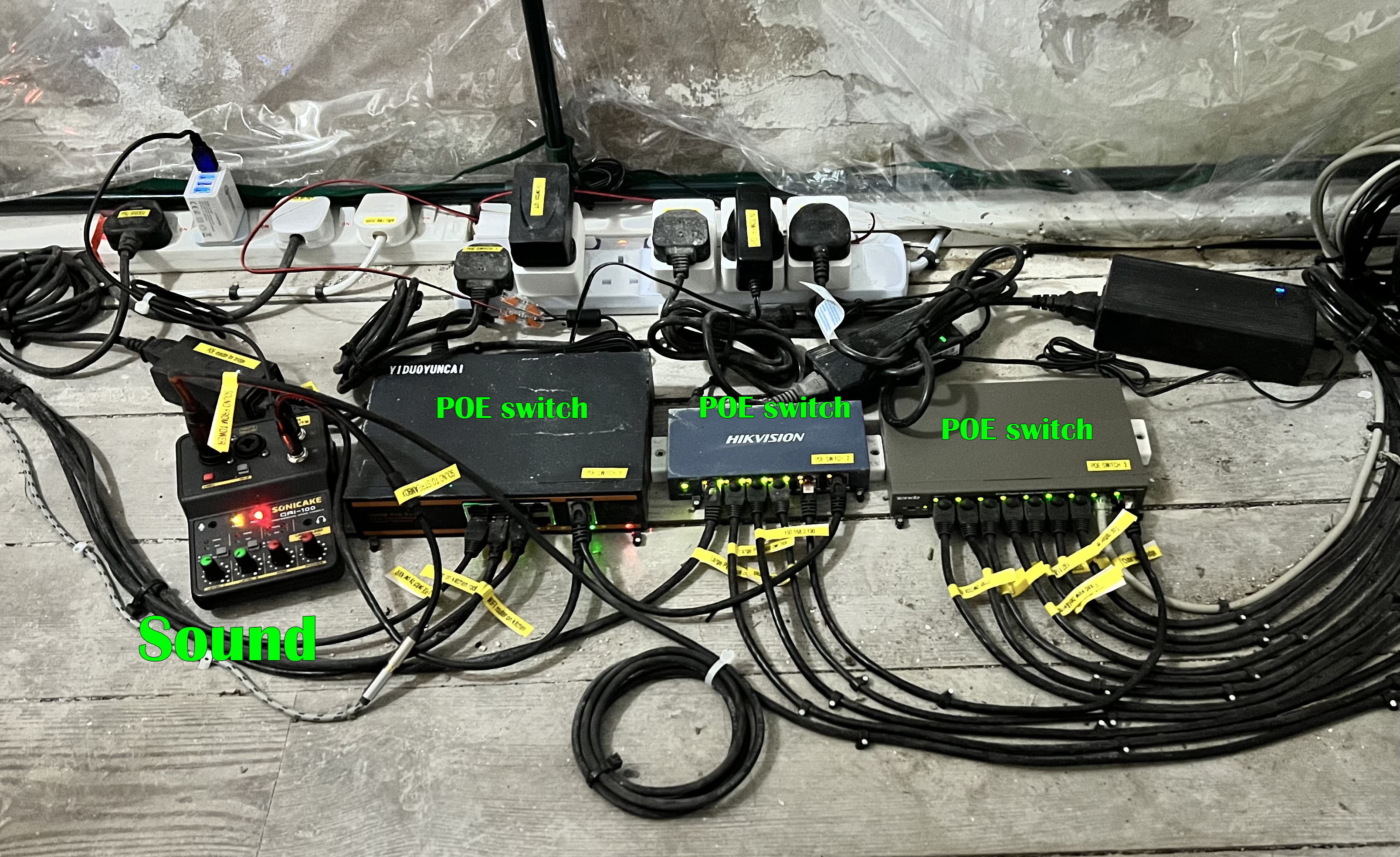

The various POE switches providing power to the cameras at the top of the tower and to various points around the church itself. The left POE is a very cheap amazon job - was the first one I bought and still doing ok - the middle Hikvision one has a boosted POE on ports 1 & 2 as we have two power hungry PTZ's - one in the tower for the owls and one in the church for livestreaming weddings, funerals etc. The third switch is a Tenda - these seem decent quality in build/size and performance - this one is powering most of the tower static cameras. We've also added an independent microphone for the youtube stream running through a budget mixer on the left hand side (it provides 48v phantom power for the microphone 30m above it). It's all covered with a greenhouse polytunnel as the walls are crumbling, and there's fine powder falling off the walls on a daily basis (this was a recent add-on as everything was getting covered).
