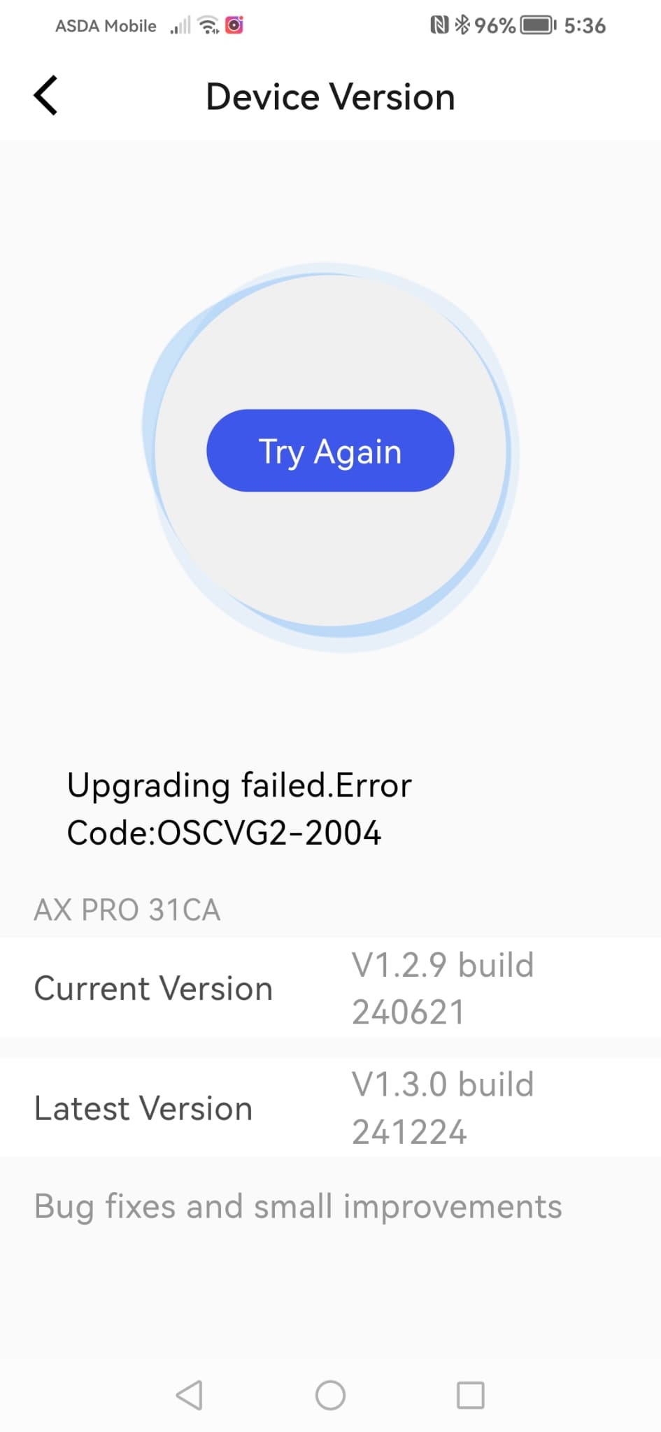

Just attempted to upgrade my AX PRO hikvision and it's bounced back an error...
Any ideas?
