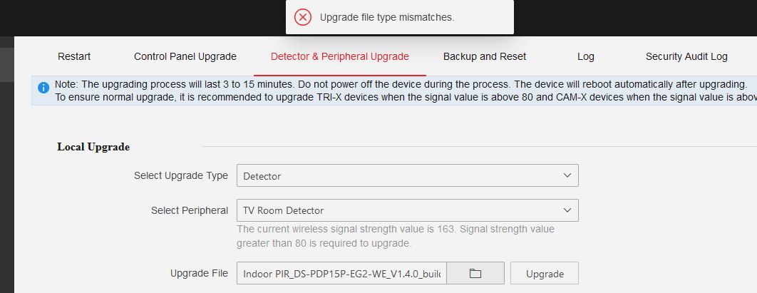

Firstly, thanks for the heads up regarding the firmware updates. Unfortunately, it seems to be location specific as I get "upgrade file mismatches" errors. I have double checked the proper model numbers and downloaded the next highest firmware compared to mine.

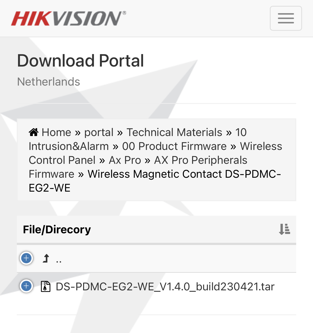

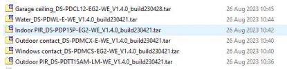

I might be wrong but the file name can’t be changed as it doesn’t accept it. Download it and keep the file name as it is with the .tar ending.
It looks to be the wrong one too
You Sir!!!, are a star!!!!!
Thank you very much, had a brain fart moment there
