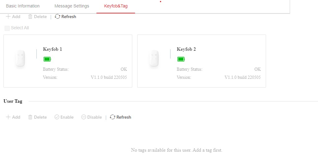

Hi, I have an AX Pro alarm system DS-PWA96-M-WE V1.3.0 build 241224 and I am unable to add the three tags that came with the system, it the hik connect app the add button does nothing and using a web browser the add tag is greyed out (see the attached picture)
I might be adding the tags in the wrong place but I cant find anywhere else to add a tag.

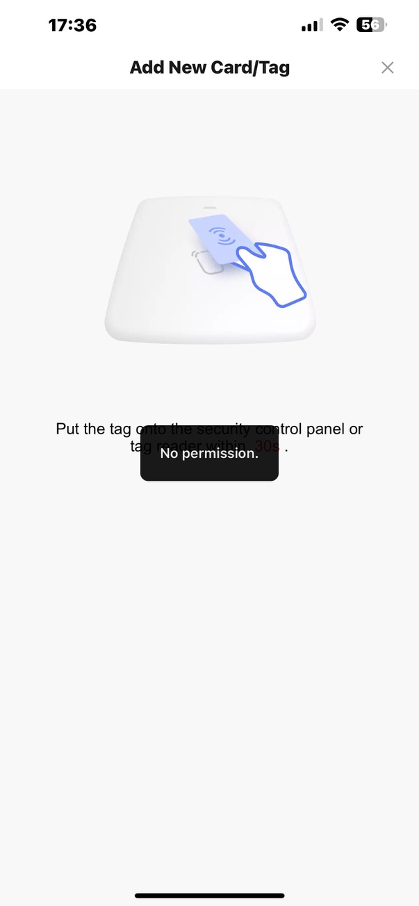

Hi there I joined the forum as I am having the exact same problem. I am an installer and I installed an AX Pro to my office.
So I have done this on iPhone 13 using latest version of Hik Connect (iPhone also latest version of iOS):
Main screen>tap 3 buttons next to alarm name>settings>user management>tap my name>tap tag>add
Then I just get a "no permission" prompt.
I have tried to go into the Hik pro connect app and change permission (as installer) for the end user (my personal account) with no luck.
I am on the verge of contacting Hik support who are usually very good. I have also logged into the panel as the installer on the web browser and cannot see any option.
If I go to a different end user, I can add the tag, it puts the reader into tag discovery mode and works fine, so I know there is no issue with any hardware. I also double checked the pros tag was working as when I present it in ordinary working mode, it shows that an unidentified tag has been presented.
Any help greatly appreciated!

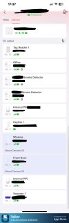

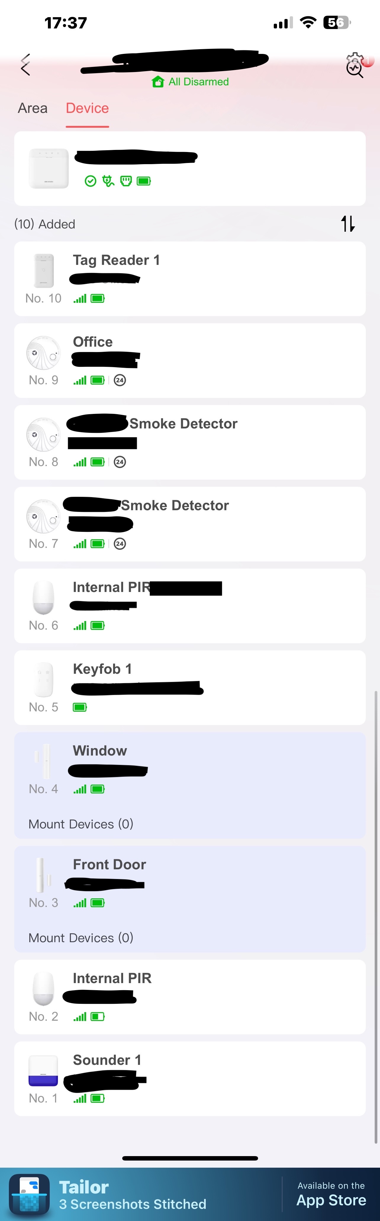

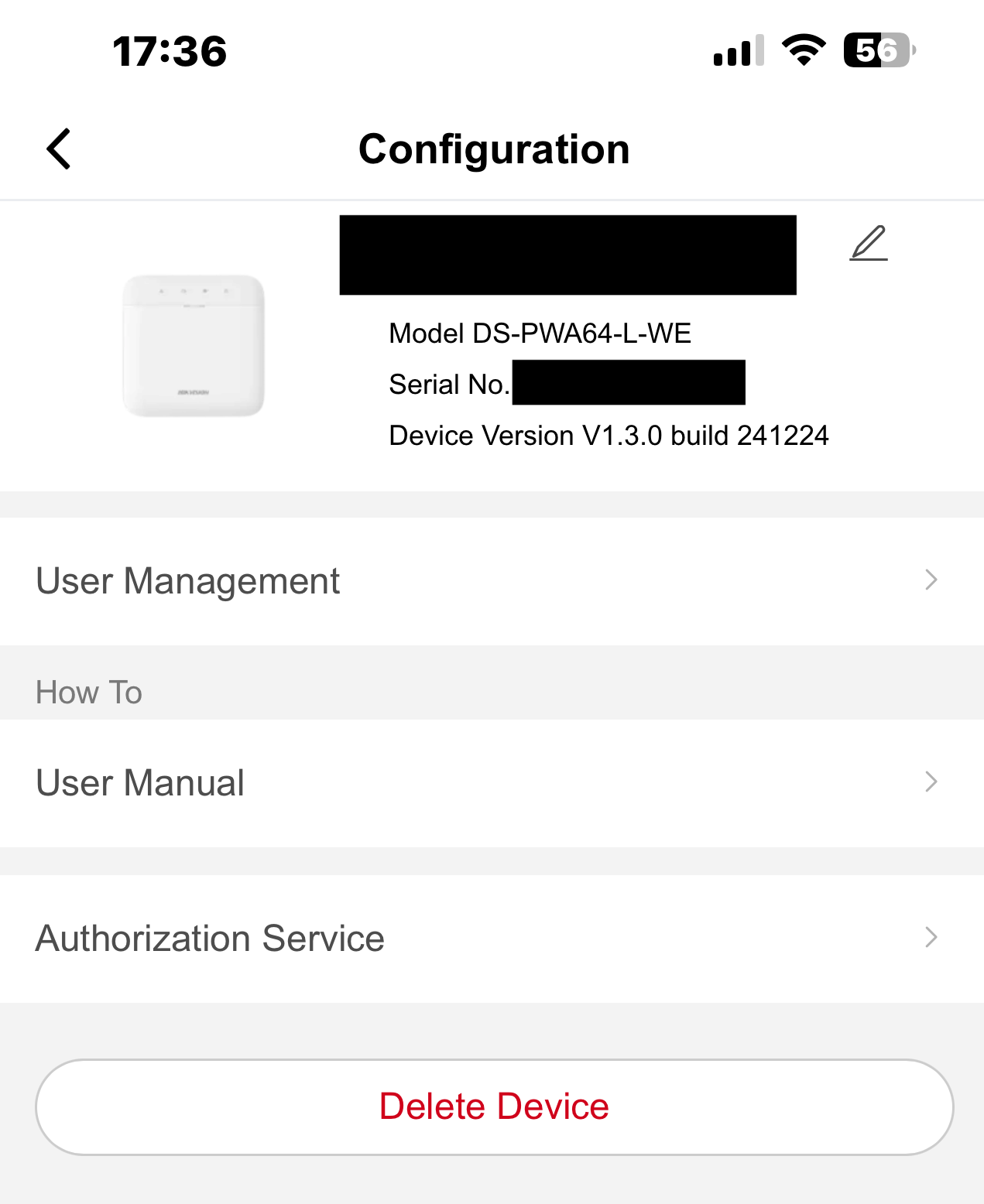

Hi guys sorry for late response... I'll add some screenshots...
Sorry I uploaded the same image twice, the third one is just showing that I have no permission when I in fact do!
