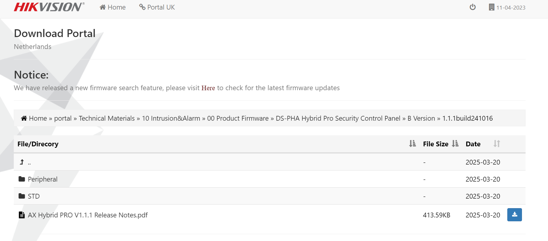

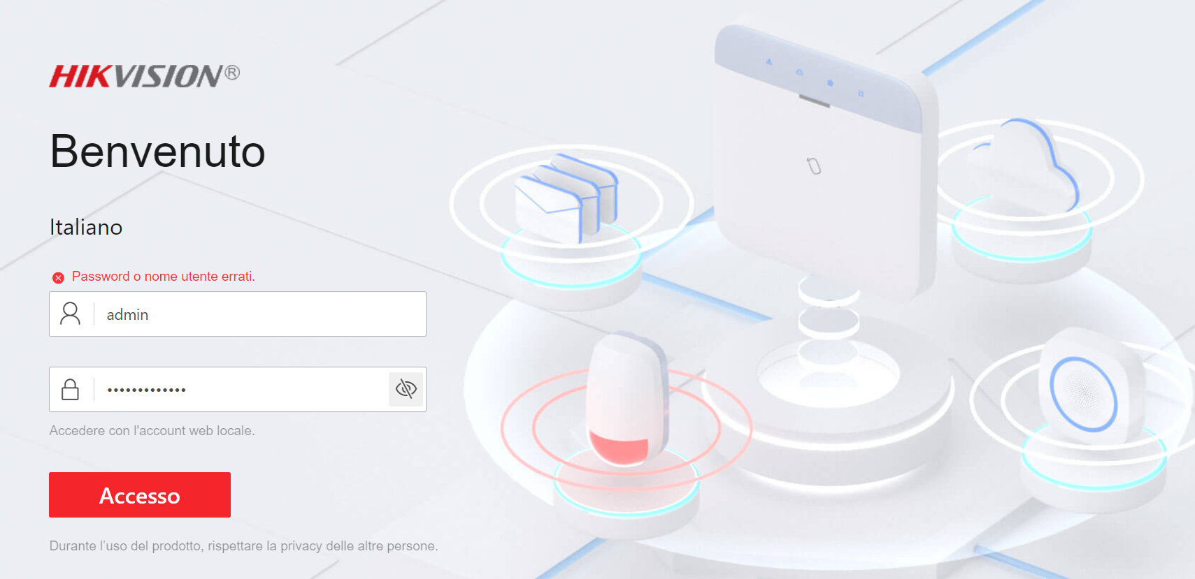

I have a DS-PHA64-LP (B). It had version 1.1.0 build 240409 and I updated it to 1.1.1 (HIA_HYBRID_H13_IT_ML_STD_V1.1.1_build241016.zip) via local file. The update went smoothly and I can see the web client login screen, however, now when I enter the same credentials, the message "Invalid user name or password" appears.

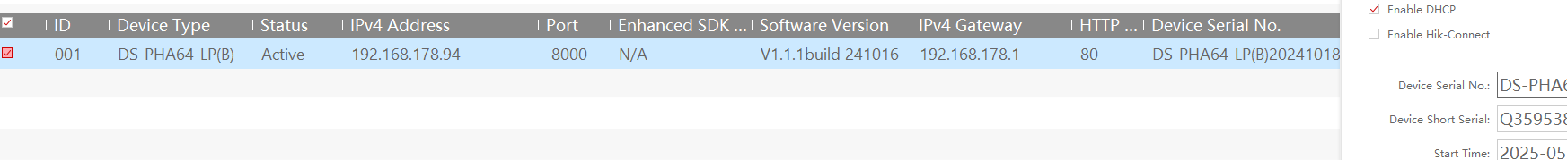

I tried resetting to factory settings, I can activate the control panel (confirmed via SADP) but the problem remains, after activation the credentials are invalid.

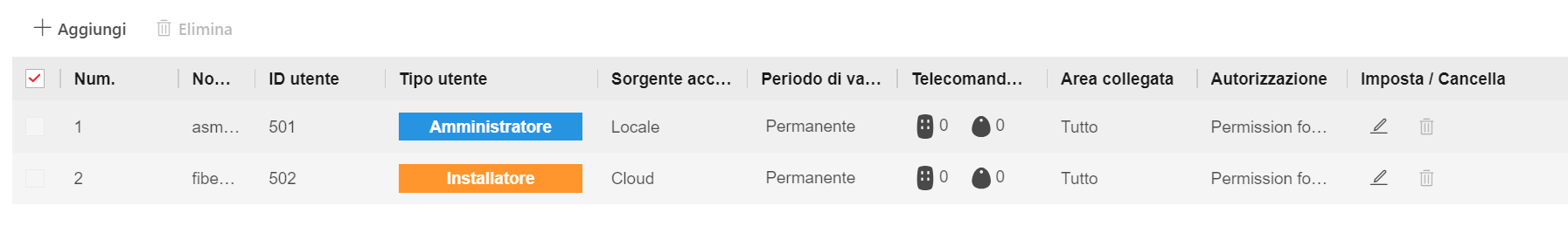

now i managed to access the control panel via hik partner login, but as an installer. how do i get back admin local access and control?
