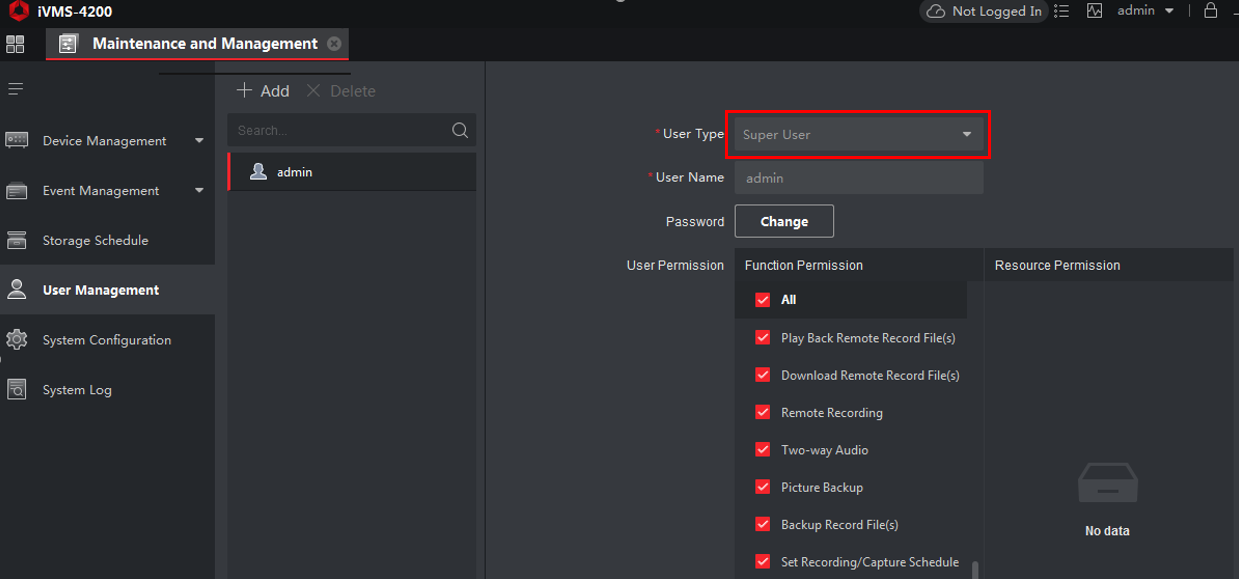

Are you logging in with the Super User account?

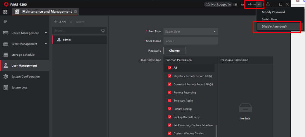

Click the drop down next to the logged in user and make sure it shows 'Disable Auto-Login'. If that option is displayed it means auto-login IS enabled (it could be more intuitive). I'm using Windows 7 and if I lock the PC and log back in, IVMS-4200 doesn't prompt me to enter my credentials again. Can't vouch for Windows 10.

Thanks Stewart for your reply. I am using the SuperUser account and Disable Auto Login is shown in the dropdown as per your post. Maybe it's a Windows 10 thing then :(

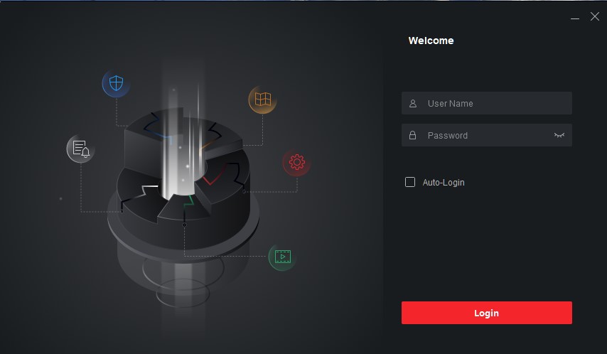

Finally found a workaround. If I 'X' out of the Welcome screen (where it prompts for the login), and then launch the software again, it auto logs in. Strange, but it works!
