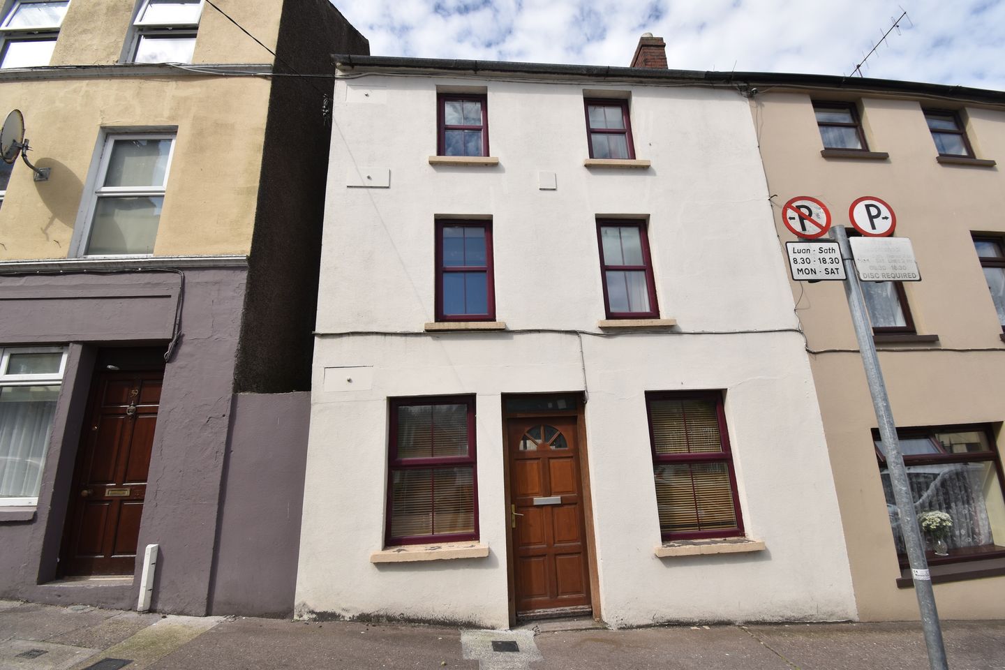

I have a townhouse, front door opens on to the street. Have had the front door tried in the past week, and this morning was threatened by some random scumbag. I am feeling a little vulnerable. I've been wanting away for a while, so would preferably like to install a system that I can access remotely as well as while I am there.
Attached is a picture of the house front.
So I figure I need 1 external camera, located to the extreme left or right, just under the second floor window level. Because it will be bent to look down and across the front door and windows, it should be a bullet, and the focal length probably minimal - 2.8mm or 3.6mm, so that it doesn't pick up everything on the path, only action at the front door or windows. I would route the cable from the camera up to the eaves, where it would link to receiving equipment in the attic, or alternatively into the front hall above the door. I believe a PoE would be best in case the wireless signal is a problem, and gets rid of the need for a long power lead. The camera should be movement only I suppose - in terms of storage, I believe the device will overwrite its recordings automatically every day or week or whatever according to the size.

Hi @curadh
Sorry to keep you waiting for a reply on this.
Our normal recommendation for a system like this would be to go with Hikvision equipment, which is Chinese, but also the most popular as it's reliable and offers lots of features at a good value.
For the camera(s), I would recommend the DS-2CD2046G2-IU as a mini bullet, which is a PoE camera and supports microSD card storage.
You will also need to use the DS-1280ZJ-XS junction box to waterproof the connections in the back of the camera if you do route the cable up into the eaves, but also follow the instructions in this guide.
If you aren't using an NVR, then you would need a PoE injector or switch between each camera and the router to supply power.
Also, I would consider mounting the cameras slightly higher than you've suggested, say >2.5m high, so that the camera / SD card is out of somebody's reach.
If you would prefer to have the camera lower down to better capture faces, then I would recommend the vandal-proof DS-2CD2546G2-IS and DS-1280ZJ-DM46 junction box.
