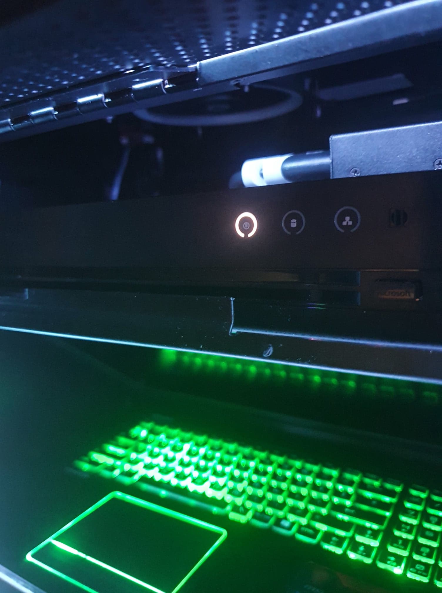

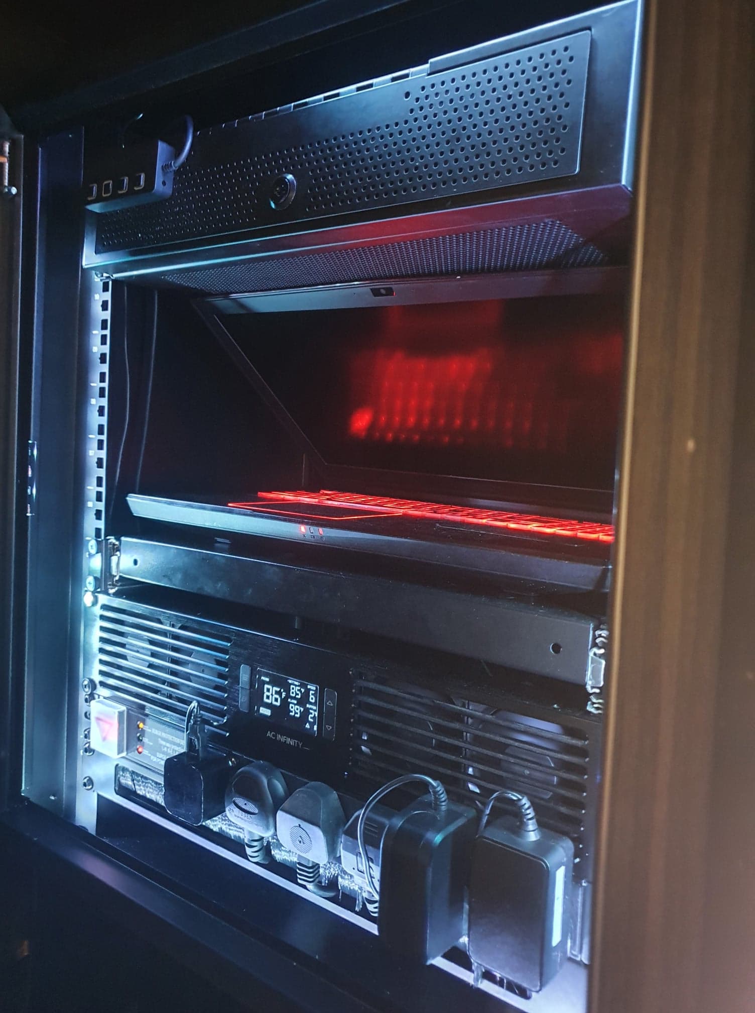

Also we currently have a CCTV vehicle thats kitted out with Normal Static Cameras and a PTZ so powering anything with normal UK plugs isn't a problem. I've attached a couple of pics of the Vehicle unit
