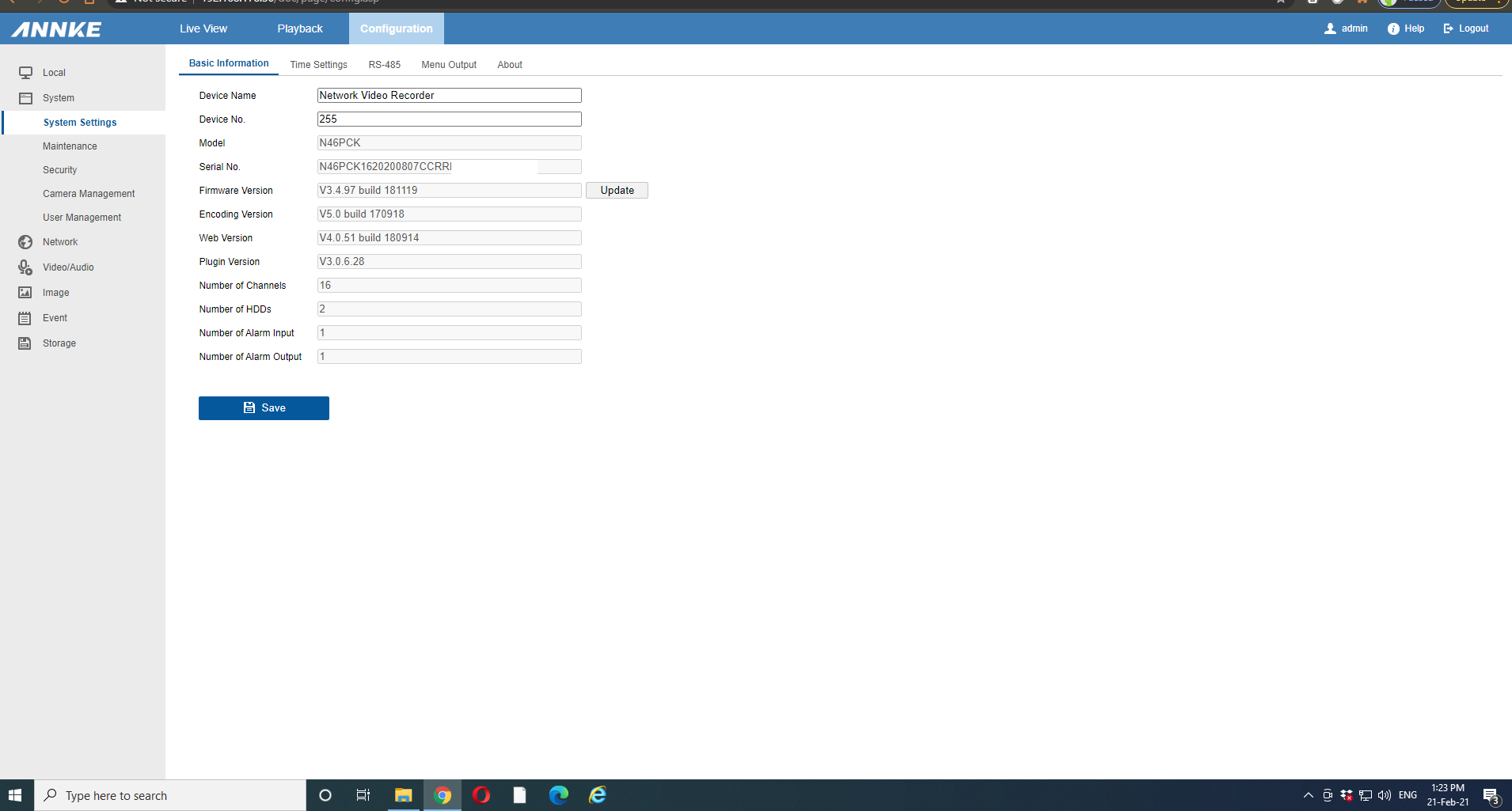

I have a Annke N46PCK NVR, it is a Hikvision 16ch OEM NVR. I am looking to update the firmware and have contacted Annke support but they state the box is up to date, I don't believe so. I also have a Hikvision DS-7616NI-K2 / 16p its updated and running okay. The Annke NVR is very similar to the Hik NVR (exact same layout and style just an Annke logo) but it is missing some features like Smart Events. I would like to update the Annke Nvr to the latest Hik firmware, possibly enable smart events. I have done this already for the Annke 8mp ip cameras that came with the NVR and it worked well with the Hik firmware. I have attached a screen shot of my NVR's configuration screen. I believe the firmware version is outdated compared to the what is available on the Hikvision UK portal. However I cannot figure out what firmware I should use to update the NVR to. I think it is a K series but then is it K1 or K2 model? Any help would be appreciated.

Yes it would be the first time I updated the N46PCK NVR's firmware. I have contacted Annke support but they are little help just generic copy and paste replies. Would my current firmware be more recent than that on their website as its v3.4.97 build 181119?
I have not took the chance of updating the firmware to Hikvision firmware, not knowing if its K1 or K2 yet, but with nightly false alarms on basic motion detection I am considering doing it and if it doesn't work just replace the NVR.
Not necessarily - e.g. V3.4.101_build180904 would be more recent ('.101' is actually later than '.97').
Usually trying the wrong version will just result in the NVR rejecting it, but it has been known to brick some of the older / grey import / rebadged models in the past, so it would be riskier in your case.

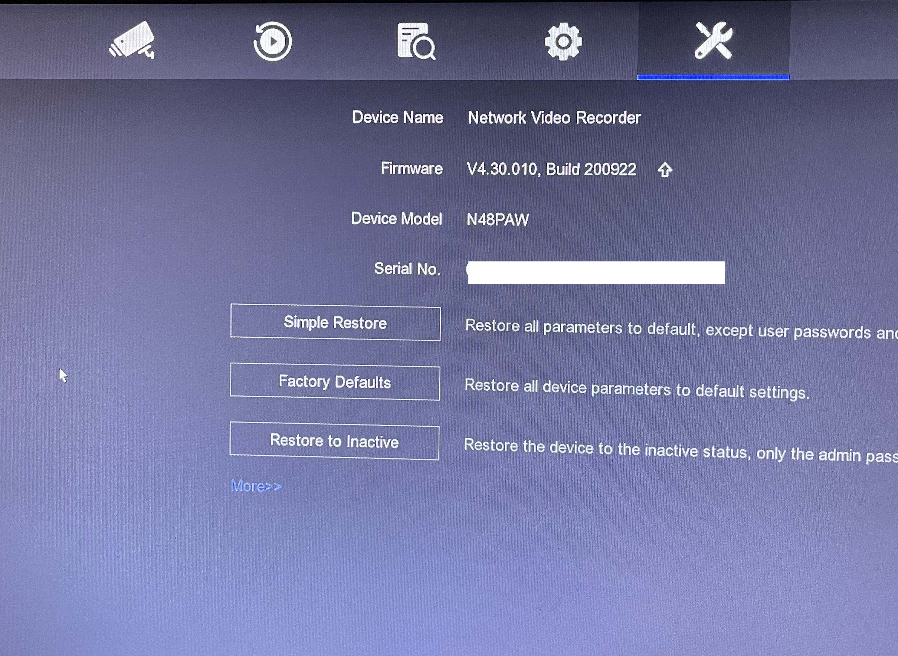

Interesting, I upgraded my N48PAW with Annke firmware which has a similar build number. I wonder if the layout is different from what Annke provided. Either way, thanks for the update MPC! I may give what you've shared a try.
Hi @1range
I should have mentioned that I was doing all the upgrades and testing from the web interface and not with the HDMI + remote. My brief check of the HMDI output did show the new 4.0 layout and styling.
I also don't have the lack of resources issue that HarrisCy reported earlier via the web interface at 2160p (but it is stuck with needing Internet Explorer 11).
