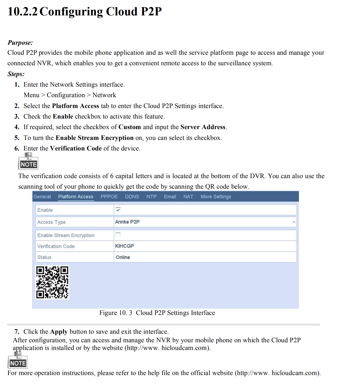

Apologies, we don't work with Annke products and I thought this was the model number of your BNC cameras.
Annke are OEM/rebadged Hikvision products so the setup for remote access is pretty much the same as the Hikvision products we regularly deal with.
It sounds like you've probably just added the DVR directly to the app using its IP address, the IP address can only be accessed on your local network which would explain why you can't access the DVR outside your local network.
What you need to do to access the DVR remotely is add it to the app using P2P/Platform Access, how to set this up is explained below:
