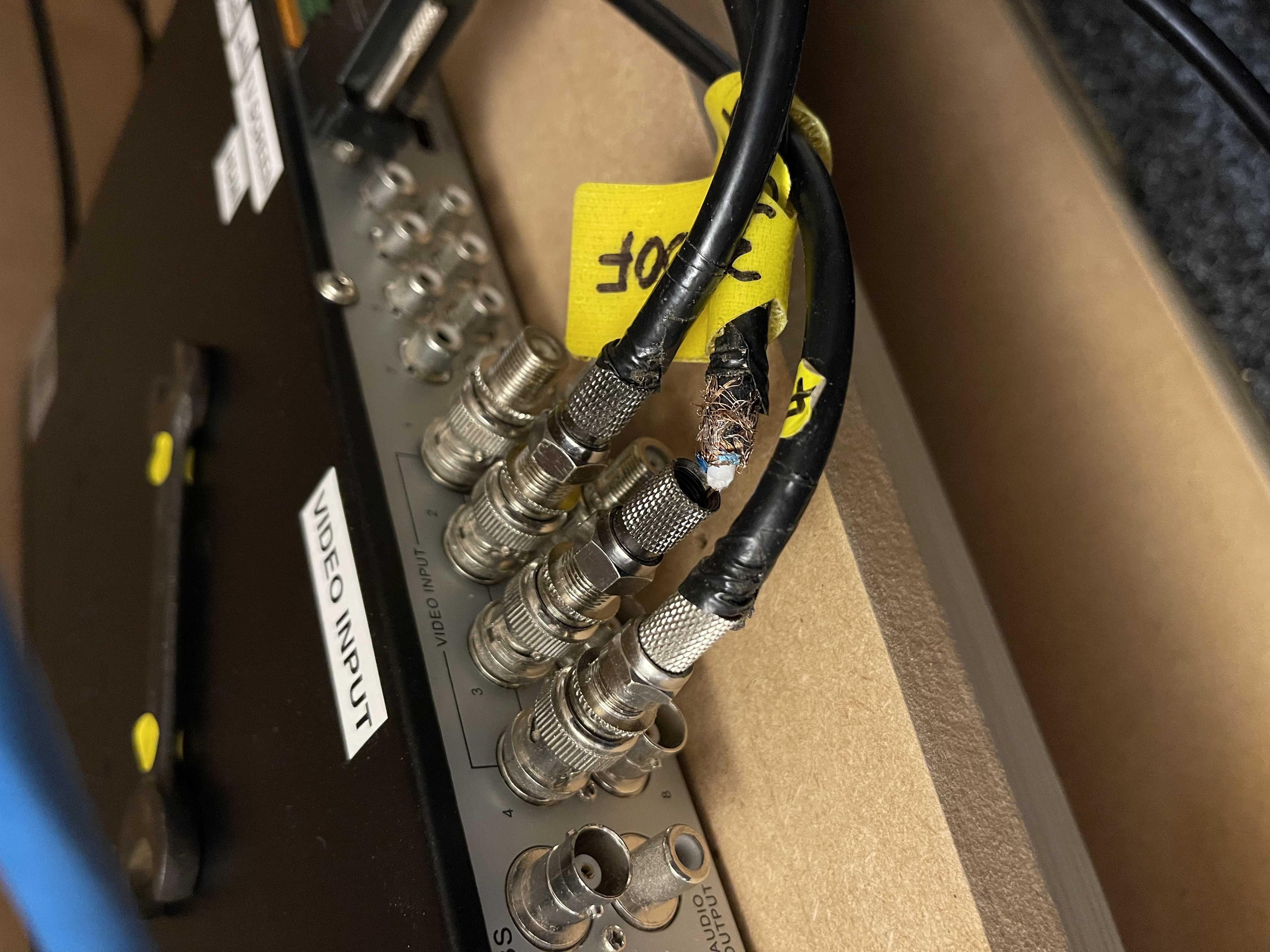

On another note, I have moved my CCTV around so many times these past few weeks due to having some re-organisation work being done in that area.
The connections are now starting to come apart due to them being moved so much.

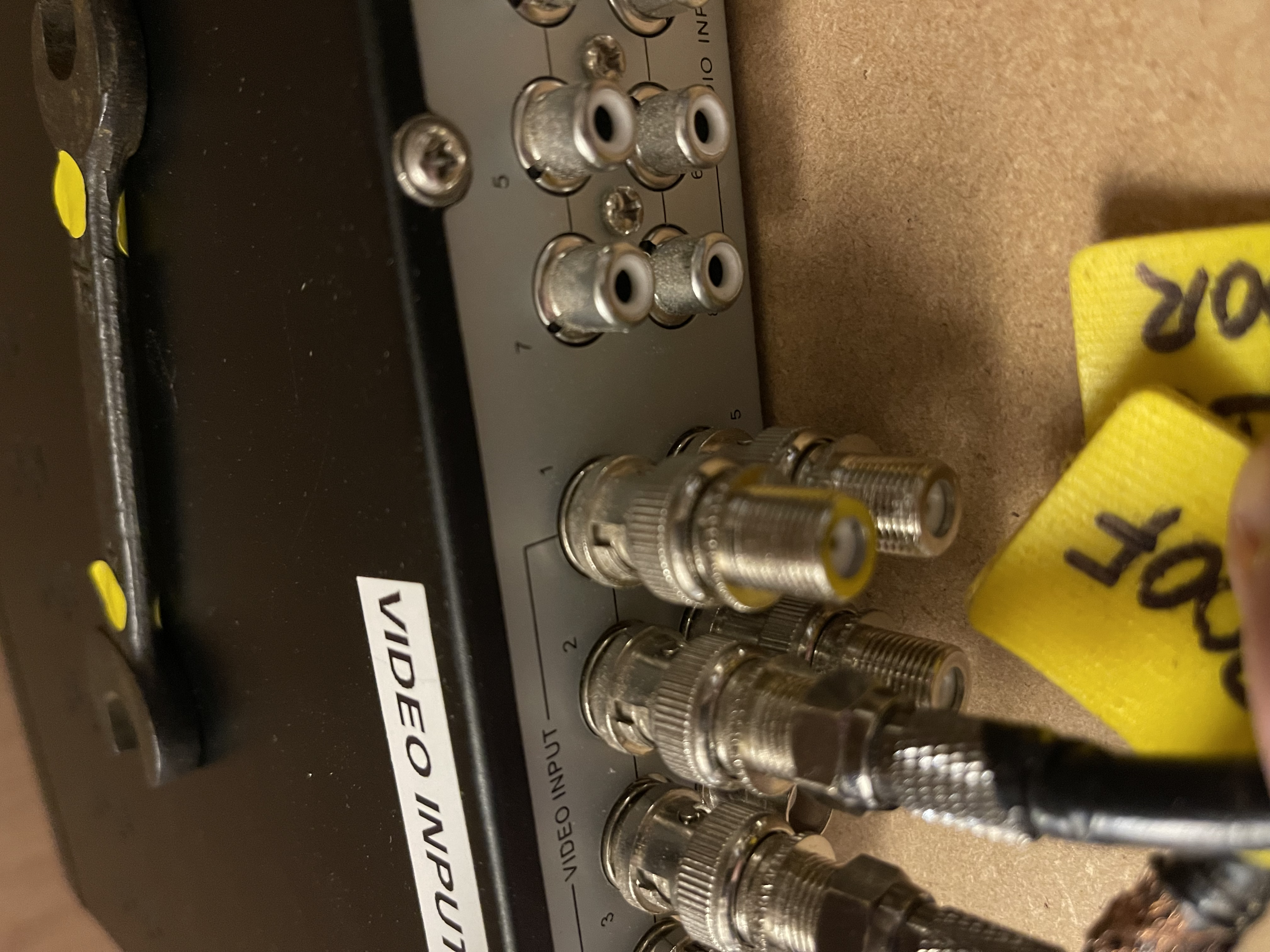

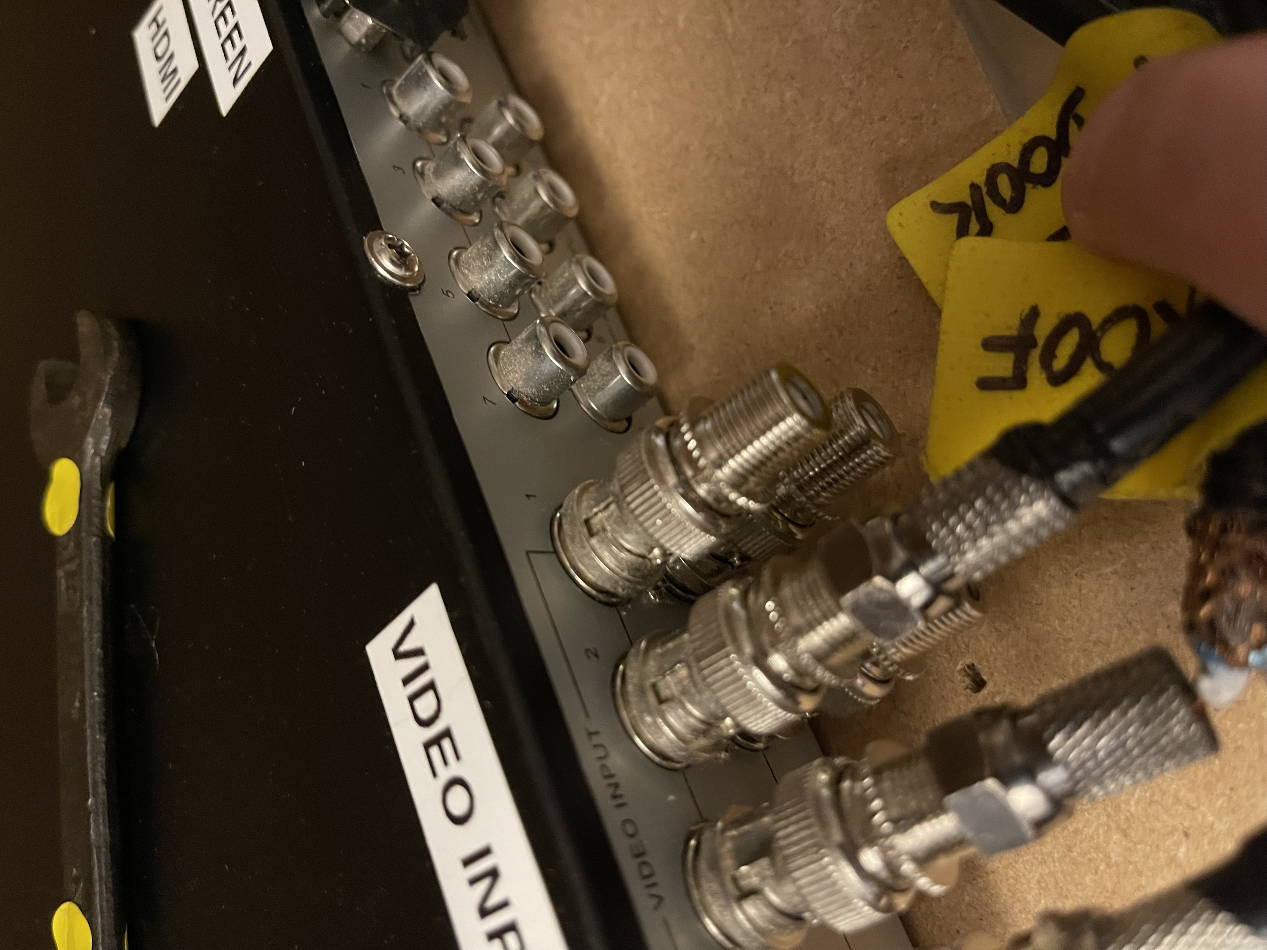

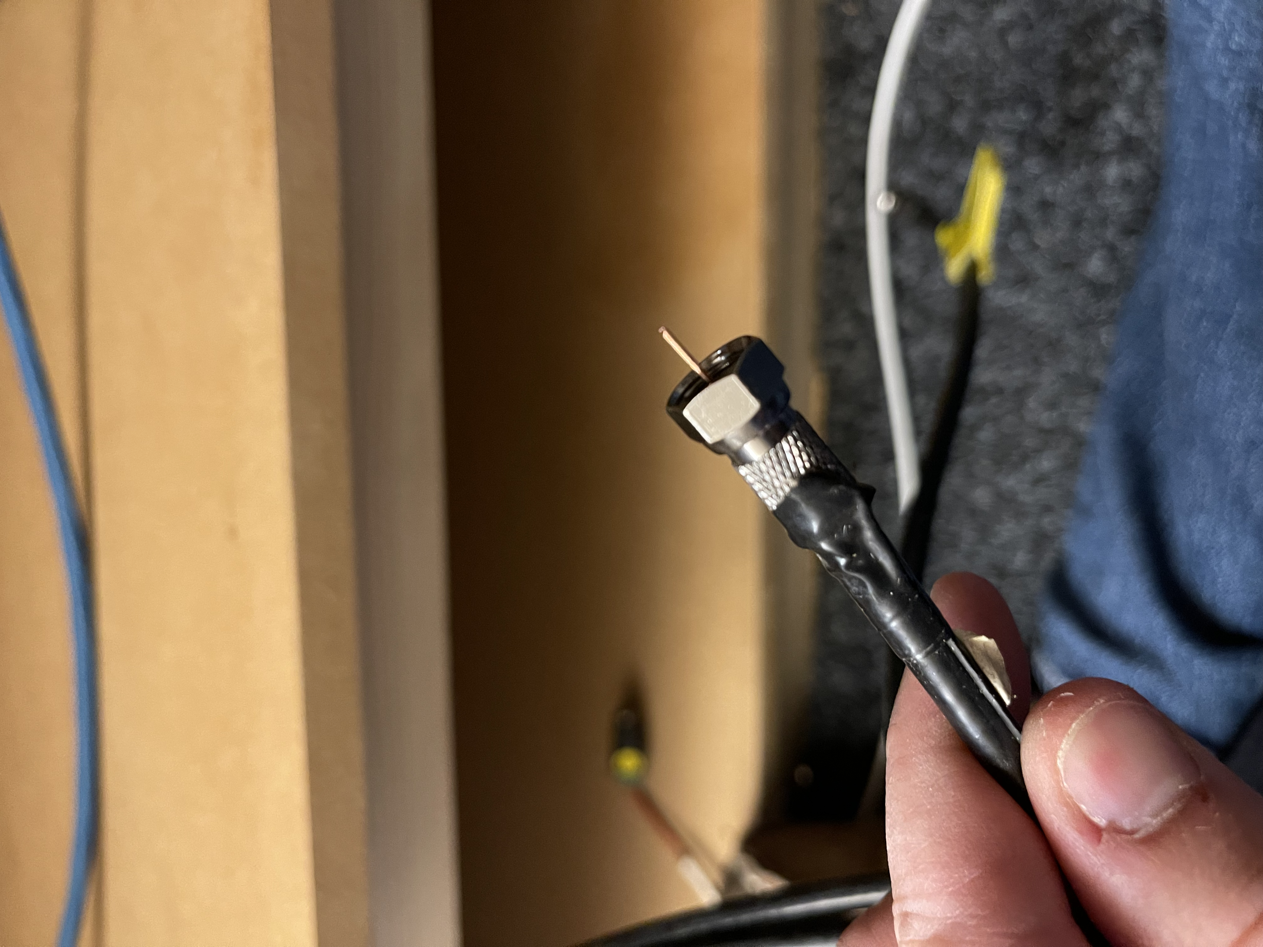

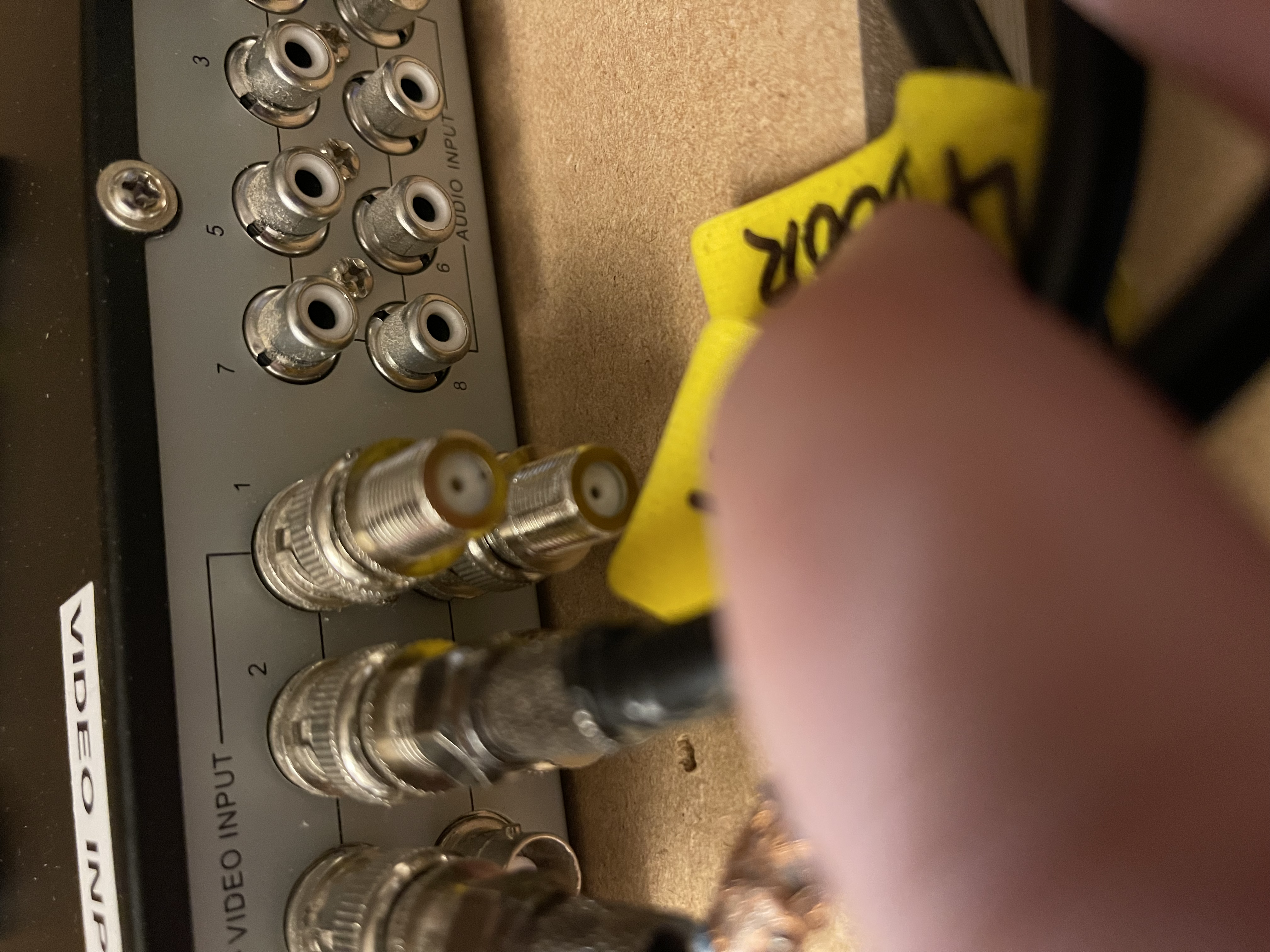

Is there anything you can buy to add to these connections to make them more plug and play (like an ethernet connection or similar), instead of having to unscrew the nut every time and damage the integrity of the connection.

It's an odd connector combo that your installer has used there.
They have crimped RF connectors onto the end of the cable, then used BNC to RF adapters to make the connection to your DVR.
Assuming it is standard RG59 co-ax cable or similar, then just fit 75ohm BNC connectors directly onto the cable ends.
