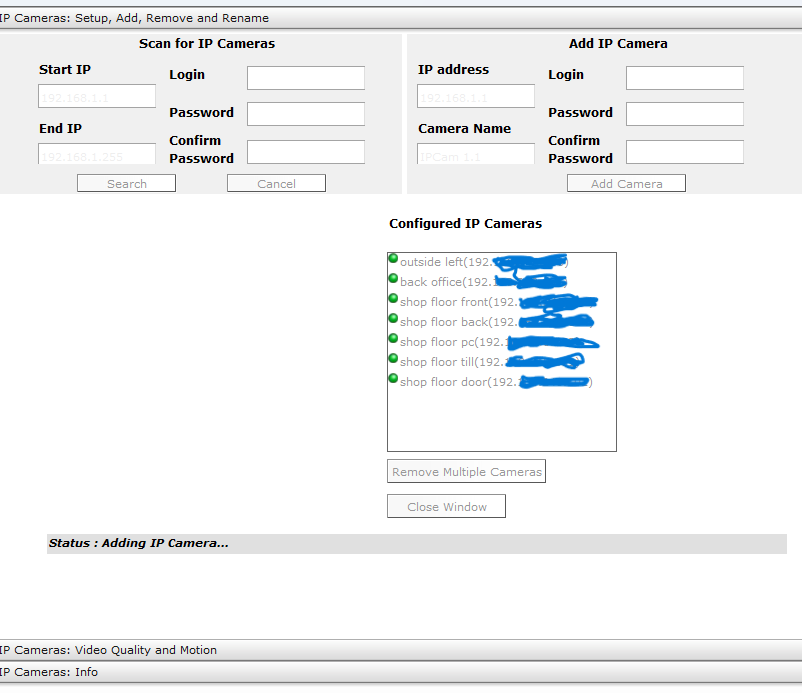

Well it looks like I somewhat managed ... lol
At least the NVR is connecting with the camera and allows to click on Add IP Camera, but despite that, the Status continuously says "Adding IP Camera"
What am I missing here?
What should I do?
