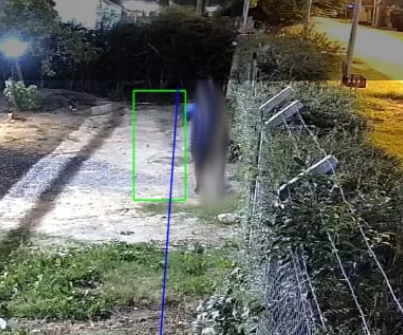

I have noticed that running Acusense on my NVR for my Colorvu camera is very slow, to the point of being practically unusable. I've set a line-crossing smart event, and I have to walk super slow in order for the NVR to trigger the event. If I walk at a normal pace or jogging it never picks it up.
The difference with Acusense running directly on the camera (when it's supported, of course) is huge. I tried disconnecting my other cameras from the NVR so that it would only process this one, but it didn't make any difference. I this something common? If it is, I'm not sure why Hikvision offers perimeter protection analysis on the NVR for non-Acusense cameras if it's basically unusable.
