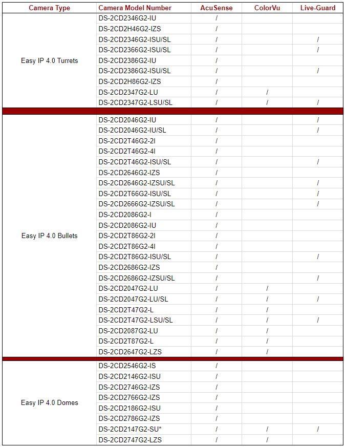

So now we have discussed the technologies and how they could be useful, you now need to decide what camera would be most suitable for you. We have composed a list below indicating which cameras in the Easy IP 4.0 range feature which of the three technologies.
*Does not feature the white supplement light.
Whereas in the past, users would have to choose between AcuSense or ColorVu, that is no longer the case. What’s more, there are even cameras that now feature all three smart technologies and they are available to order from use-IP:

Hi Emma, I confused about AI Human/Vehicle detection on AcuSense vs ColorVu. All Pro-series colorvu cameras also state that they support Human/vehicle classification based on deep learning e.g. this one
Does that mean all ColorVu cameras support AcuSense as well?
Hi @LoinKing
Yes, all ColorVu models also support the AcuSense features. See the table above where you will see all the 2xx7G2 ColorVu models have a tick in both the AcuSense & ColorVu columns.
