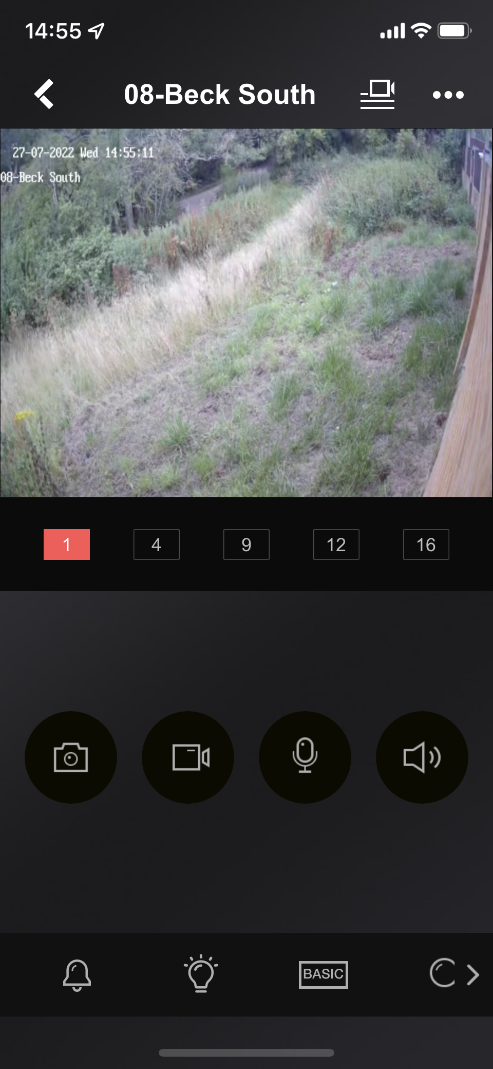

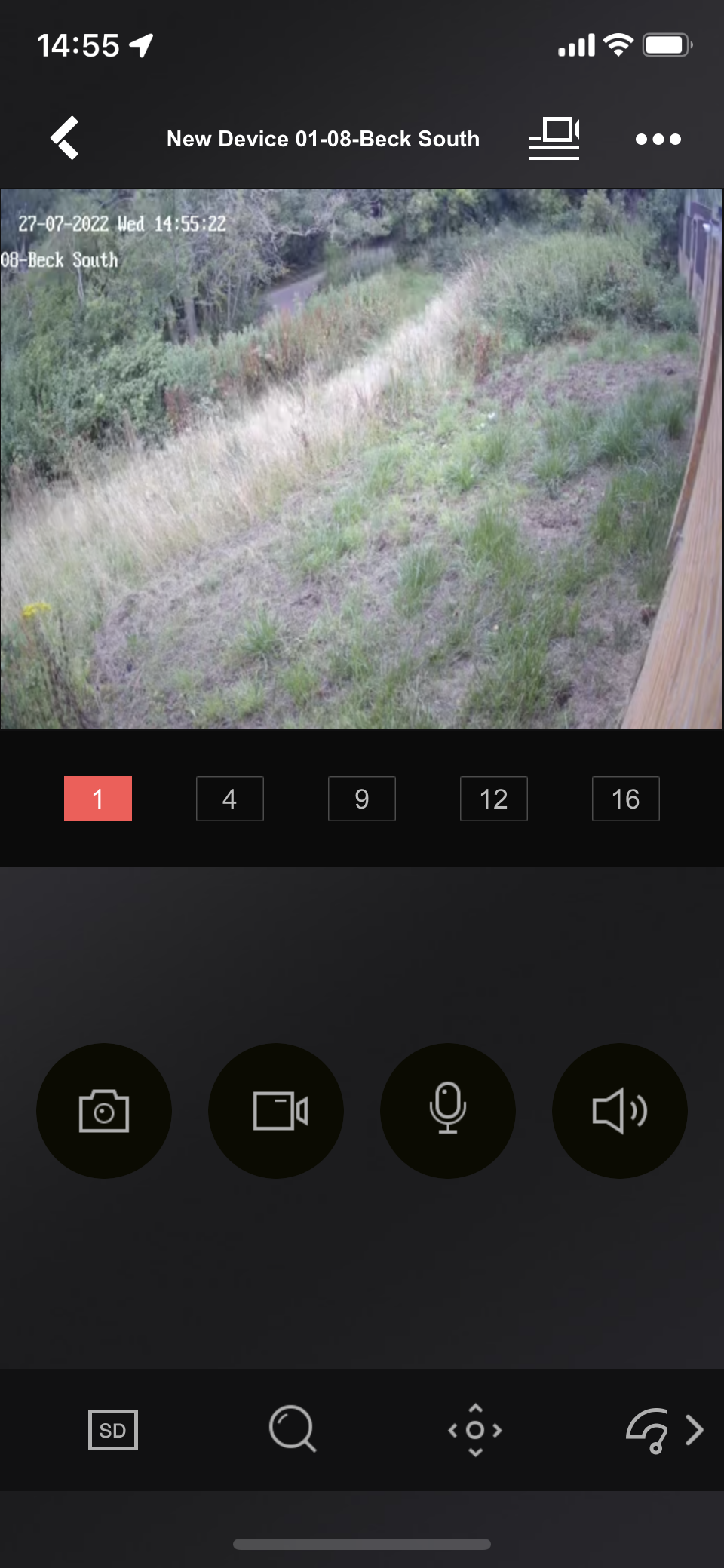

The other requirement is that the camera is registered with the Hik-Connect service and your Hik-Connect app is logged into the Hik-Connect service. Push notifications and the ability to manually trigger the siren or strobe are dependent on the Hik-Connect service. See the two images below of my system. In the first image I'm connected to my system using the Hik-Connect service and you can see in the lower left corner the two icons that manually trigger the strobe and audible warning. In the second image, I'm connected directly using the systems IP address and you can see the icons needed are missing. There's no way around this. To get full functionality - push notifications, manual activation of siren/strobe, event clips etc you have to use Hik-Connect.

Ok so that shows you have the 4 megapixel turret LSU/SL which is 'Live Guard' and I can see from the icons that you're connected to the camera using the Hik-Connect service. According to Hikvision information, with the bell showing disabled, it should stop the push notifications AND the audio / strobe alarms. If it doesn't then either the Hikvision information is misleading or it's a bug. Can you confirm what version of firmware is on the camera and what version the Hik-Connect app is. The latest firmware for that camera (G5 platform) is 5.7.3. The latest version of the Hik-Connect app is 4.24.2 (that's iOS, I'm not sure about Android)

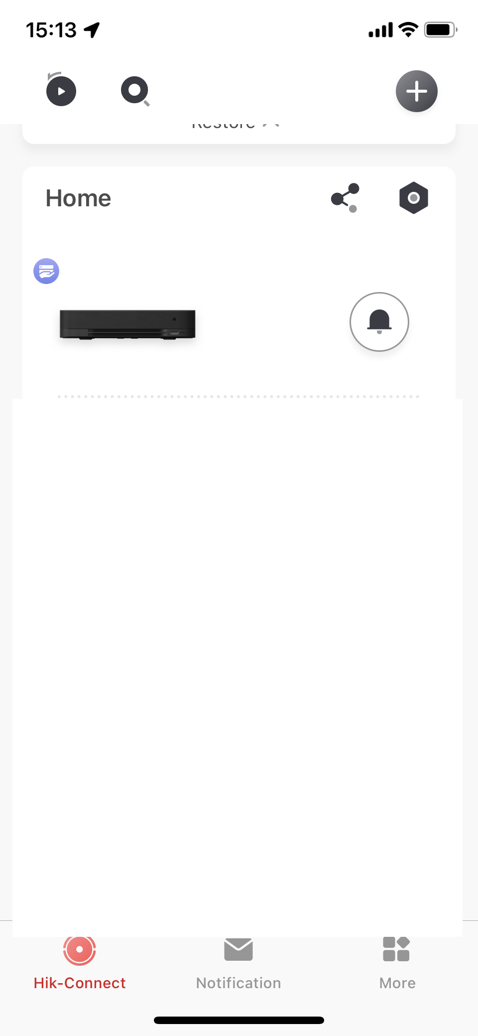

On the image you posted, although it's not working as intended, you have the arm/disarm bell icon. I've added two separate cameras to Hik-Connect (a G3 platform DS-2CD2346G2 and a G5 platform DS-2CD2347G2) and do not get that icon so it would be useful to know what versions you have so I can find out why. Thanks.

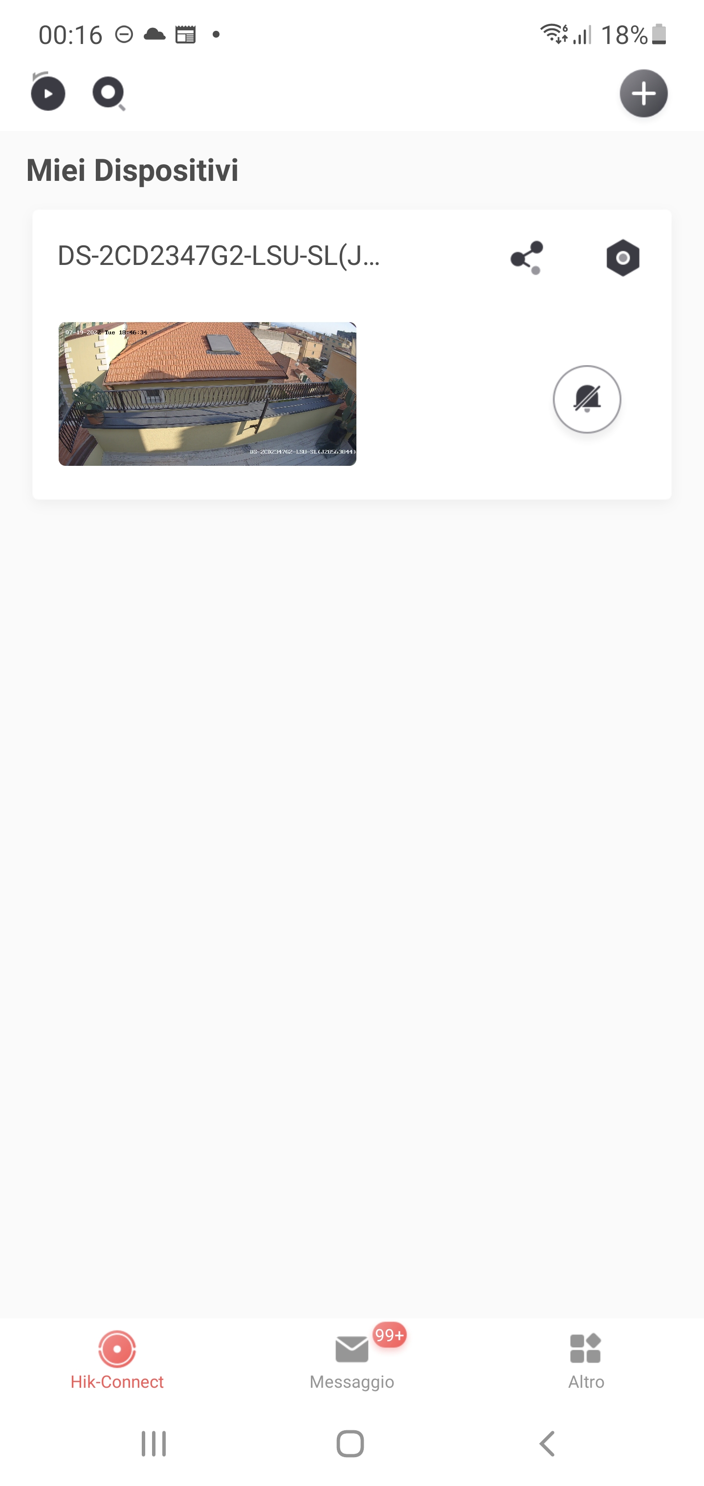

Hi guys, i am sorry...you are actually right.
The siren and the strobe light can be disarmed with the bell icon as you suggested ! I thought I tested but I did not and I was in someway mislead by the video in life guard website that say the NVR is needed.
For info I have firmware v5.7.10build220608 and Hikconnect 4.23
